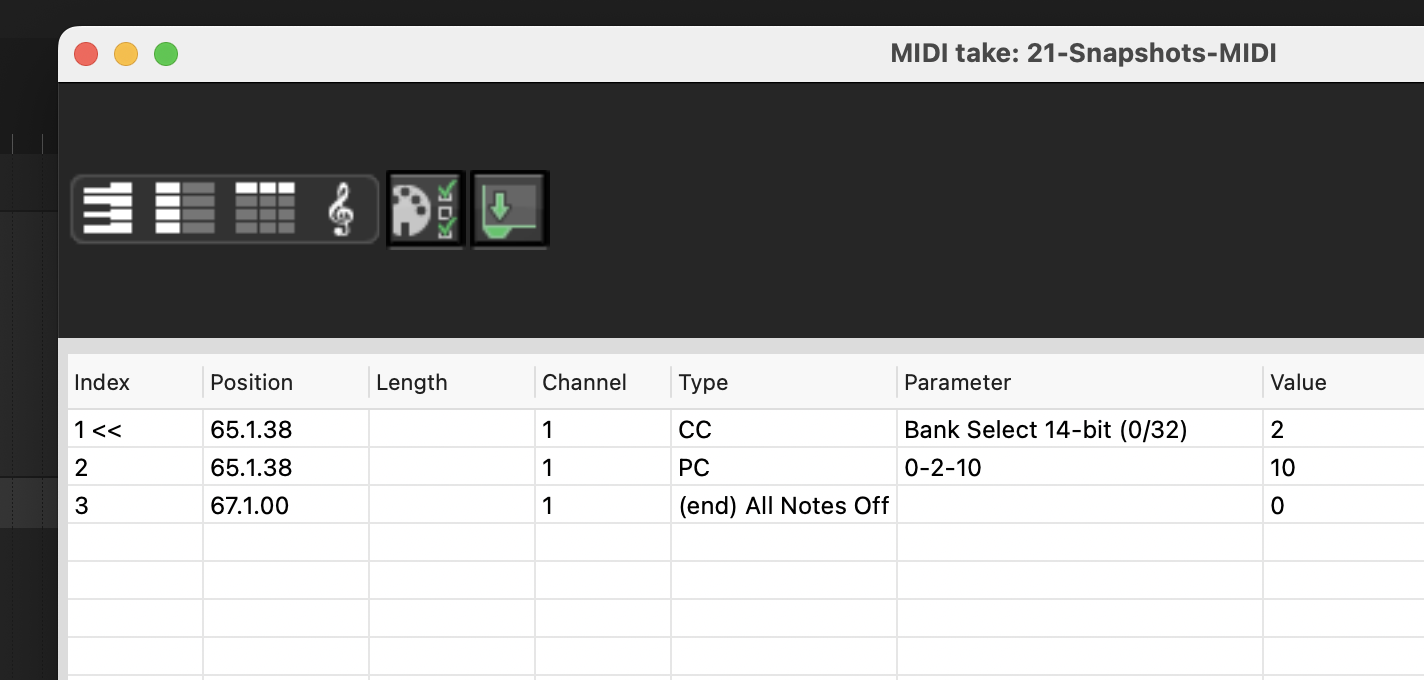

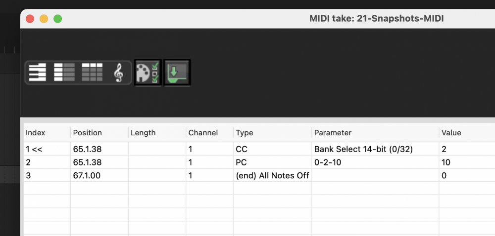

rd2rk Posted October 24, 2025 Share Posted October 24, 2025 Your .mov link isn't found and your attachment is .php which is not supported. In the MIDI Event Editor go to ACTIONS and select "Insert bank/program select event. Enter the LSB (that means CC#32) VALUE (SetList#). Enter the Program #. If that doesn't work attach a screenshot of the Reaper MIDI Event Editor. Below toggles between two setlists and presets. Quote Link to comment Share on other sites More sharing options...

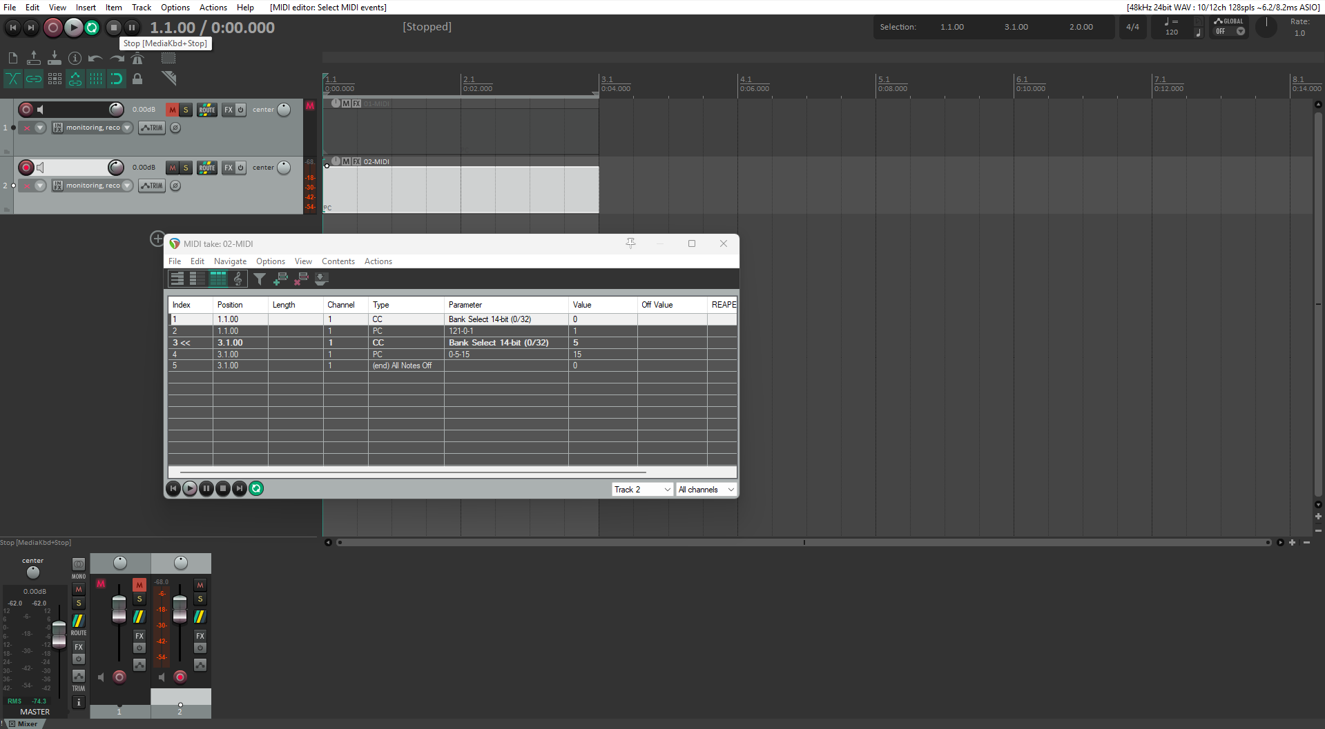

minefield Posted October 24, 2025 Author Share Posted October 24, 2025 I appreciate your prompt reply. I don't want the midi message to toggle but just select the setlist and preset when triggered. here is the screen recording on dropbox. https://www.dropbox.com/scl/fi/y2yy3qq3ks8fn6nr47ftl/Screen-Recording-2025-10-24-at-11.30.44-am.mov?rlkey=mivehcakphjup8ps4sbsgz5sa&dl=0 and the Midi event editor Quote Link to comment Share on other sites More sharing options...

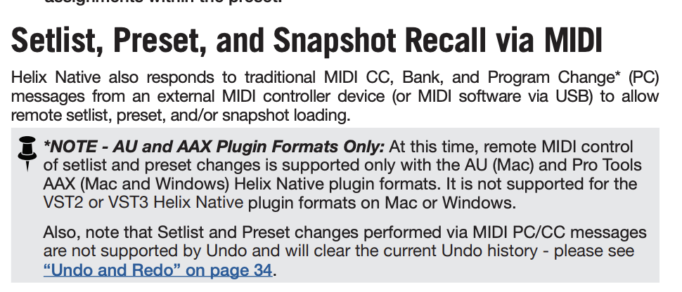

minefield Posted October 24, 2025 Author Share Posted October 24, 2025 i does say in the pilots guide to use the AU version Quote Link to comment Share on other sites More sharing options...
rd2rk Posted October 24, 2025 Share Posted October 24, 2025 Yes, I'm aware. As I said, I didn't know that Reaper could run the AU version even on a MAC. I have used the AAX version with ProTools, but I hate ProTools and, TBH, having the HW Helix, I only ever use Native for re-amping. But FWIW - changing SetLists and Presets works fine in ProTools with Native AAX. Quote Link to comment Share on other sites More sharing options...

rd2rk Posted October 31, 2025 Share Posted October 31, 2025 While we're waiting for @datacommando, a couple of things. I've assumed that you are using the Reaper MIDI Editor to hand enter the MIDI events vs using an external controller to RECORD the MIDI events. There may have been some confusion over that. Try this. Place a MIDI Monitor on the Native track to see EXACTLY what is being sent to Native from the MIDI track. Take a screenshot of the MIDI Monitor so we can see exactly what is being sent. While it LOOKS like you have the Event List correctly configured to change to Setlist 3, maybe in this case confirmation might help track down the problem. *If your MIDI Monitor doesn't diisplay in decimal by default, see if there's a switch to make it do that. Translating from HEX is not a big deal, just annoying. EDIT: Factory 1 is by default Setlist 1 - CC#32 Value 0. User1 is by default Setlist 3 - CC#32 Value 2. The screen recording looks like it's starting in Setlist 3, then switching to Setlist 1. In both Setlists it's landing on Preset 10. This is not what your screenshot of the Event list is telling it to do, so something else is going on. Please follow my suggestion re the MIDI Monitor screenshot. Quote Link to comment Share on other sites More sharing options...
