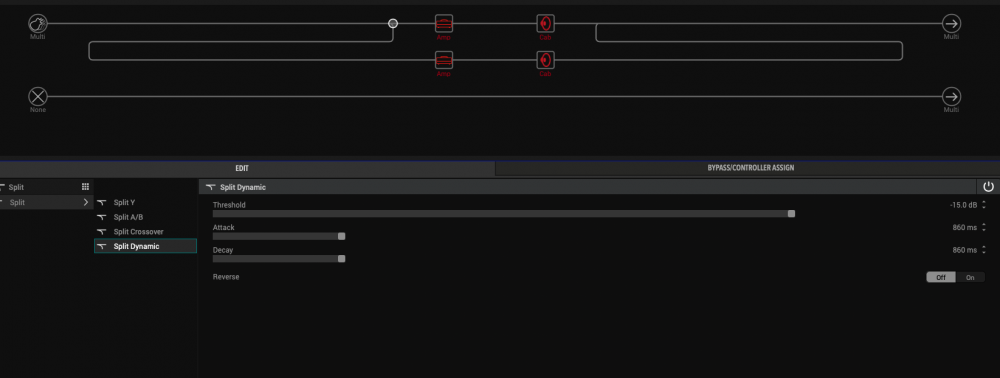

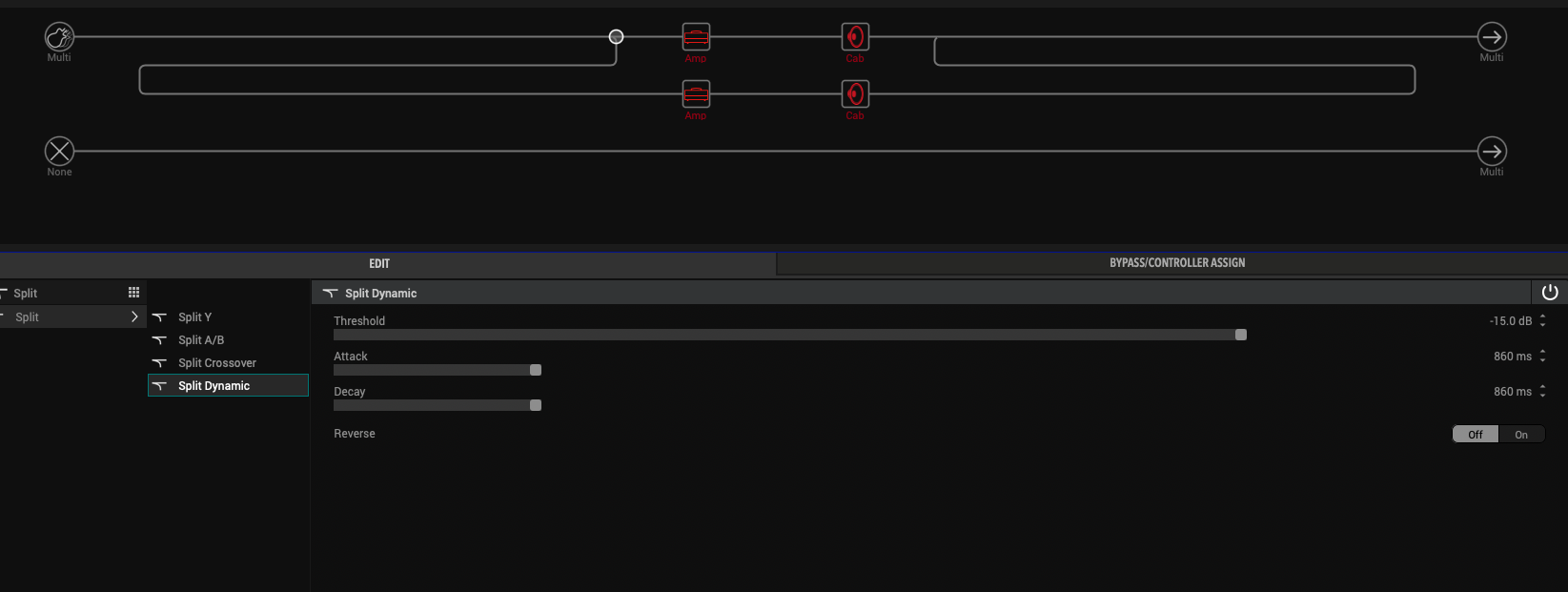

RobBaartwijk Posted October 24, 2025 Author Share Posted October 24, 2025 I am taking a dive into the split settings(dynamic) so I can use two cabs for a mix of the sound. Apparently you can select a frequency to 'split' the sound into the two cabs. That way I should be able to control the tone with my tone control know on the guitar. Add more high and the other cab kicks in. And when/if I can get that to work I can even put the split before the amp and add one more amp to respond to the dynamic split. To be continued... :) Quote Link to comment Share on other sites More sharing options...
SaschaFranck Posted October 24, 2025 Share Posted October 24, 2025 On 10/24/2025 at 12:32 PM, RobBaartwijk said: I am taking a dive into the split settings(dynamic) so I can use two cabs for a mix of the sound. Apparently you can select a frequency to 'split' the sound into the two cabs. That way I should be able to control the tone with my tone control know on the guitar. Add more high and the other cab kicks in. This is defenitely not working just as easy as it seems to be. I'd try to keep it simple for a start. The right combination of compression, boosts, drives and amps can take you a long way already. Here's a little silly thing I recorded when someone asked for a somewhat fuzzy yet dynamic sound out of the HX ecosystem. It's not exactly like a rhythm/leads thing, but think it works pretty well. https://drive.google.com/file/d/1nhNYRGXFWBFEs1ZEeykXW4RTtScjlsnI/view?usp=sharing Quote Link to comment Share on other sites More sharing options...
