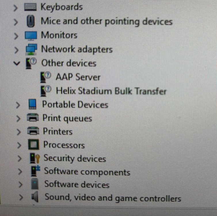

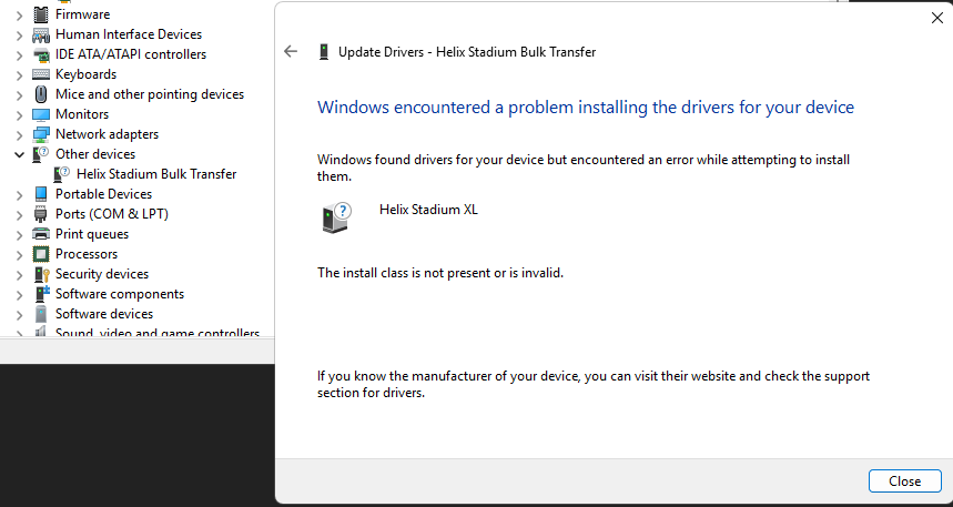

Unknown device "Helix Stadium Bulk Transfer" in Windows10/11 device manger
ReverendLove
Dear ladies and sirs
Wednesday last week I reported this issue. Now we (mostly me) are poking around this issue stupidly. Support insists on "This is am unknown issue.". Very helpful. I consider this as clueless nonsense as someone has made this device and its representatiom. I tried every USB-port, did an install/uninstall circle four or five times and even build a new Wim10-machine from my device vaults but this shows the same issue as my actual Win11-machine.
I am a line6 customer over 20 years but now I am really scared ny this obvious quality isuue and the ignotance or shiftlessness of the European support.

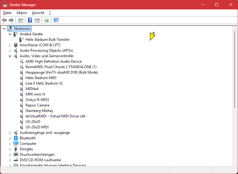

You don't sound ignoramt.
Thing is: The standard drivers for midi and audio just work as the asio driver does.
Communication with wifi even works. So it's unlikely my usb ports are the cilprit.

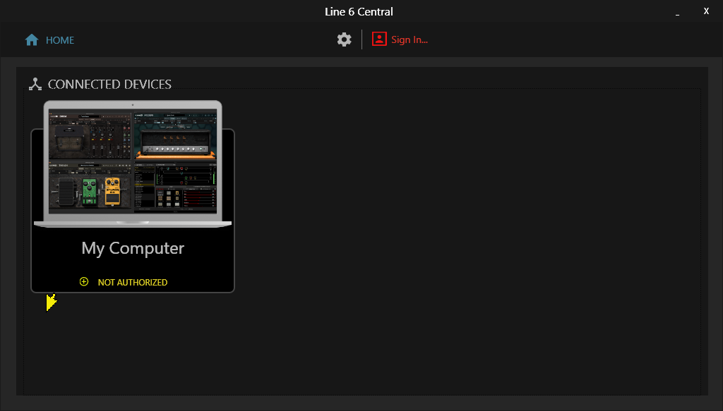

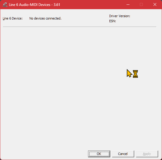

But in Line6 Central and and Line6 Audio-Midi Device Control (System Control ) is nothing present. They're empty.
I cannot ignore this issue as Line6 decided to make firmwase updafes on USB. That will not work here because
Line6 Central does nothing and Helix Sradium App crashes immediately connecting to usb.

Yeah I tried this too several times, even with mining through the registry for any lime6 / halion remnants.
But don't or didn't you have this" Helix Stadium Bulk Transfer" thing in your device manager?
If not how the Stadium is presend in your device nabager?

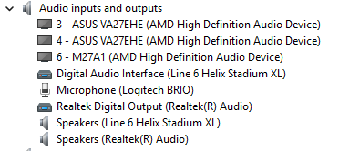

I have several instances in the Device Manager.
The digital audio Interface and Speakers In Audio I/O
I have the Line 6 instance
I also have one instance in Sound Video & game controllers as itself
I also have a third HID Keyboard device when attached

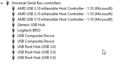

(screenshot w/ Stadium attached; w/o Stadium attached
Here is a screenshot under Software Devices within Device manager

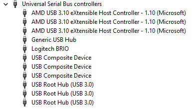

It is an additional (third in my case) USB composite device
with stadium                                                                                w/o stadium
I have looked in many other areas within Device Manager and do not see any other instances.
