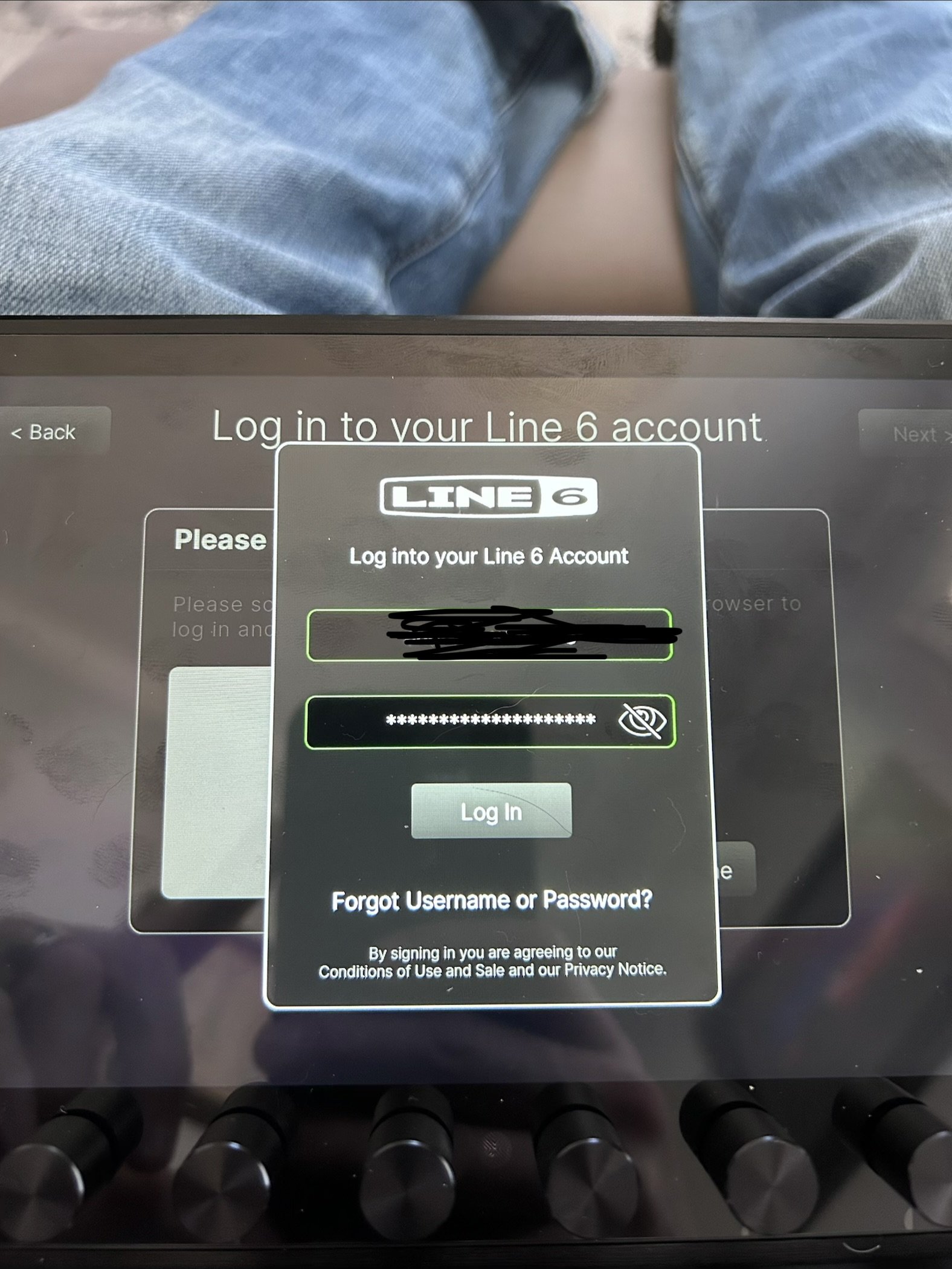

andrew_summers Posted January 13 Share Posted January 13 Running latest firmware via usbc update directly from computer to the stadium xl. I am not able to authenticate to the Line6 servers and they said they are looking into it. If it is their servers then why is the problem so isolated and not hardware related? Has anyone else experienced this? It’s frustrating to have a brand new piece of (expensive) gear and not have any idea which way this is going (replace unit or wait for them to fix a problem for a small group of users?). Any ideas or possible remedies? Quote Link to comment Share on other sites More sharing options...

Jago1234 Posted April 7 Share Posted April 7 my helix is doing the same thing new out of the box. I push login and nothing happens Quote Link to comment Share on other sites More sharing options...
Jago1234 Posted April 7 Share Posted April 7 I just talked to support he had me skip setup go into global settings turn off wifi date setting and set it to the current date. from global setting go back to account login and every thing worked no problem 1 1 Quote Link to comment Share on other sites More sharing options...
