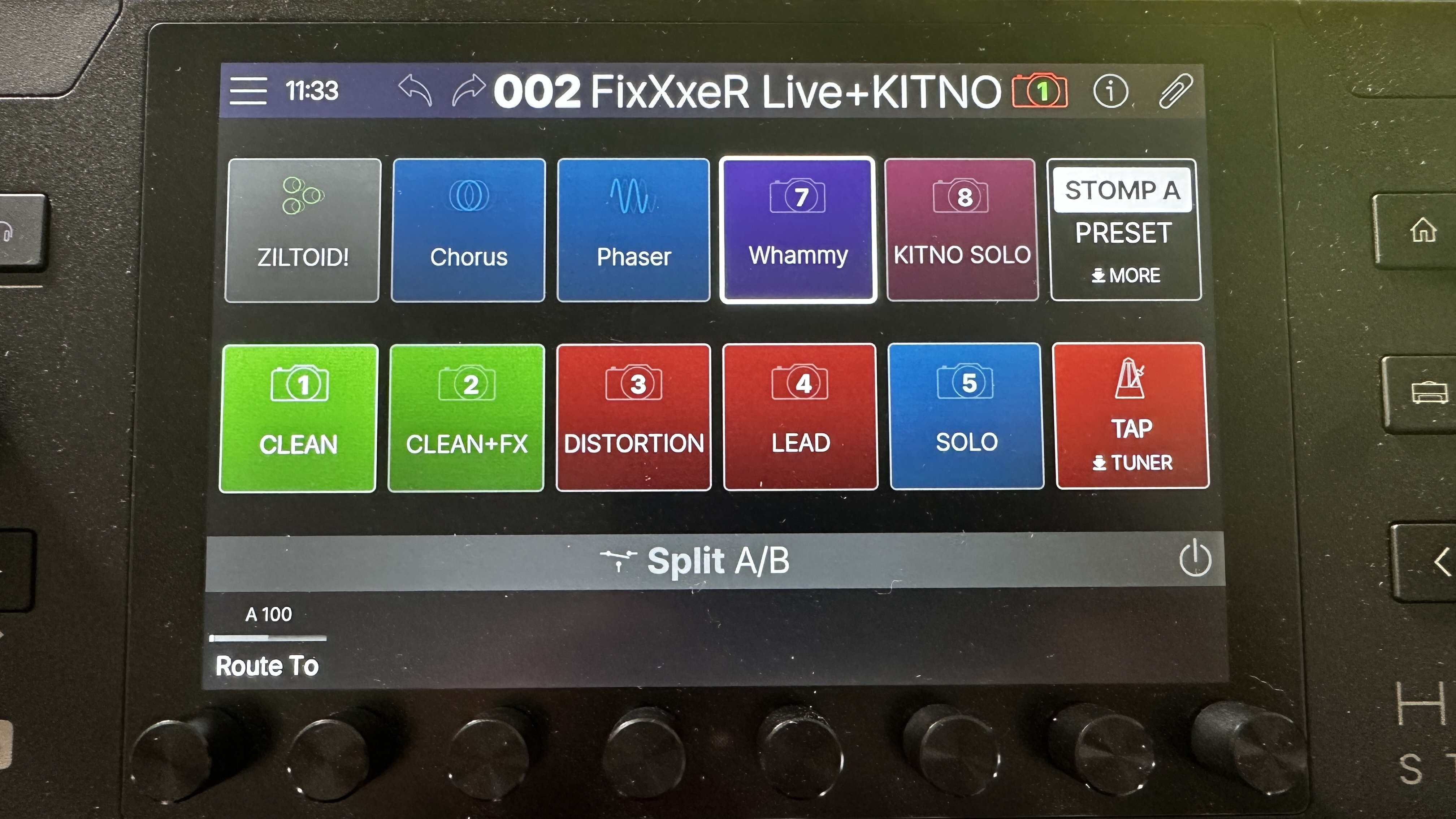

Mobi Posted October 8 Share Posted October 8 I have the Helix stadium floor together with a Mission EP-1 expression pedal connected via TRS cabel to the herlix control A/B input. I use snapshots. I use a wah pedal and a whammy pedal both controlled by the EP-1 pedal. I have created a split signal on my chain where the whammy pedal is on my main chain, and a split with the wah pedal in paralel. On all my snapshots my wah pedal auto activates when I move the EP1 expression pedal and the whammy pedal is disabled. That works fine. The problem is this: On 1 snapshot I want the wah pedal to be disabled/not cactivated by my EP1 expression pedal. Instead I want the whammy pedal to be active and controlled my the EP1. I am unable to do this! I can enable the whammy in the snapshot, but when I move the expression pedal it not only controls the whammy but also still activates the wah pedal! I have disabled the split signal on that snwpahot which contains the wah pedal, so in theory the wah pedal should not be heard in the signal, but it is still activated and you can hear it. The 2 pictures in attachment are: 01: Snapshot with split enabled and wah gets activated when I move my Mission EP1 pedal 02: Snapshot with split DISABLED (wah disabled) and whammy enabled. When I move my Mission EP1 pedal the whammy is working, but the wah still auto engages and also can be heard. Quote Link to comment Share on other sites More sharing options...

Mobi Posted October 13 Author Share Posted October 13 So ok, I think I have finally solved my own problem... Instead of using the Y split block, I have used the A/B split block. Put the wah in the split. When I want only the whammy to be heard I set the route in the split to 100% to A where the whammy is located. When using the Snapshot for KITNO SOLO the A/B split sends the signal only to A. The wah is still enabled and controlled by the same Mission EXP pedal, but you can't hear it. (well I need to test this setup as I use the 4 cable method to connect the Helix to my Dual REctifier amp. Below snapshot is used for Distortion + wah pedal. The A/B split is disabled so the signal goes through the wah and also through the whammy but whammy block is disabled: Below snapshot is used for KINTO SOLO: The A/B split is enabled so the signal goes only to path A where the whammy is. whammy block is enabled: Quote Link to comment Share on other sites More sharing options...

Mobi Posted October 16 Author Share Posted October 16 On 10/13/2026 at 3:09 PM, silverhead said: Good! You might want to submit a support ticket to clarify what the expected behaviour of the Split Y block is when deactivated. You may have identified a bug. If you do submit a ticket please report back. I'd be interested in seeing the response. I opened a support ticket. They asked me to upload the preset with the y split. They tested it and said they can not hear the wah in the preset. I tested the same preset and for me but the wah is still on together with the whammy (which is wrong as I only want to hear the whammy in that particular preset)! So clearly something is wrong. But now with the A/B split my problem is solved. I will report back to that ticket to tell them. If you want you could simulate my problem and see if your unit has the same behaviour or not? Quote Link to comment Share on other sites More sharing options...
