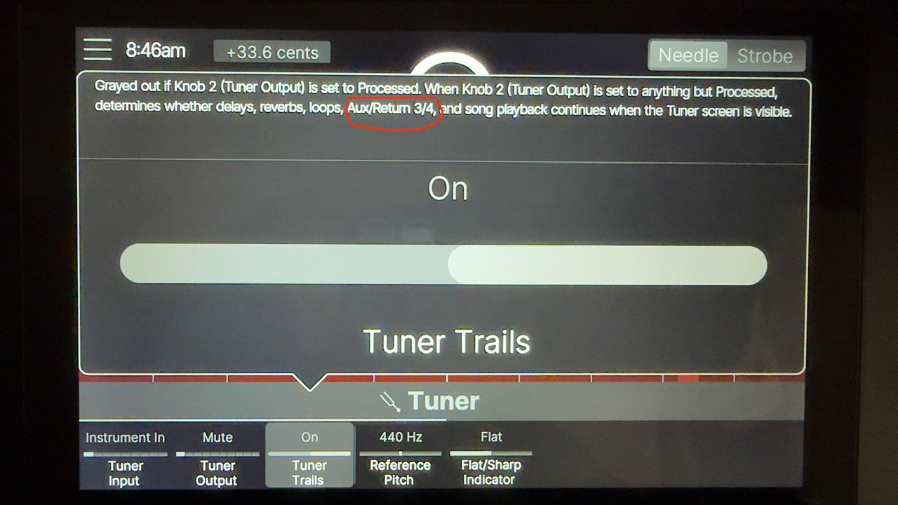

littlespaceman Posted October 20 Share Posted October 20 On 10/19/2026 at 11:18 PM, silverhead said: If the Tuner Input is set to only Guitar, then other inputs such as XLR or Return should not be recognized by the Tuner and hence should not be muted. This is exactly the problem; in my case, I have my guitar connected via the Instrument input, and I have the Tuner Input selected to Instrument only. I have the output set to 'Mute', which according to the manual = Mute: The input signal is muted completely (although it respects the Tuner Trails setting). This implies to me that it should mute only the input signal selected in the Tuner Input setting, and not ALL the inputs (otherwise what's the point of having selectable tuner inputs?) But for reasons I don't understand, when set up this way it also mutes everything else, including the Return 1 input, and therefore my mic... I've also tried setting Tuner Trails to 'On' which according to the manual = Tuner Trails Determines whether the natural decay of Delays, Reverbs, FX Loops, and the Aux/Return input continue when the Tuner screen is opened. Does not apply if Tuner Output is set to “Processed.” However, on the Helix screen, the explanation of the Tuner Trails function says on Aux/Return 3/4 continue, which is a significant difference as the Stadium Floor doesn't have a Return 3/4, it only has Return 1/2 Quote Link to comment Share on other sites More sharing options...
silverhead Posted October 20 Share Posted October 20 Thanks for your detailed investigations, @littlespaceman. This sounds like a bug. I suggest that anyone experiencing this open a support ticket. Please report back to let us know the response. Quote Link to comment Share on other sites More sharing options...
