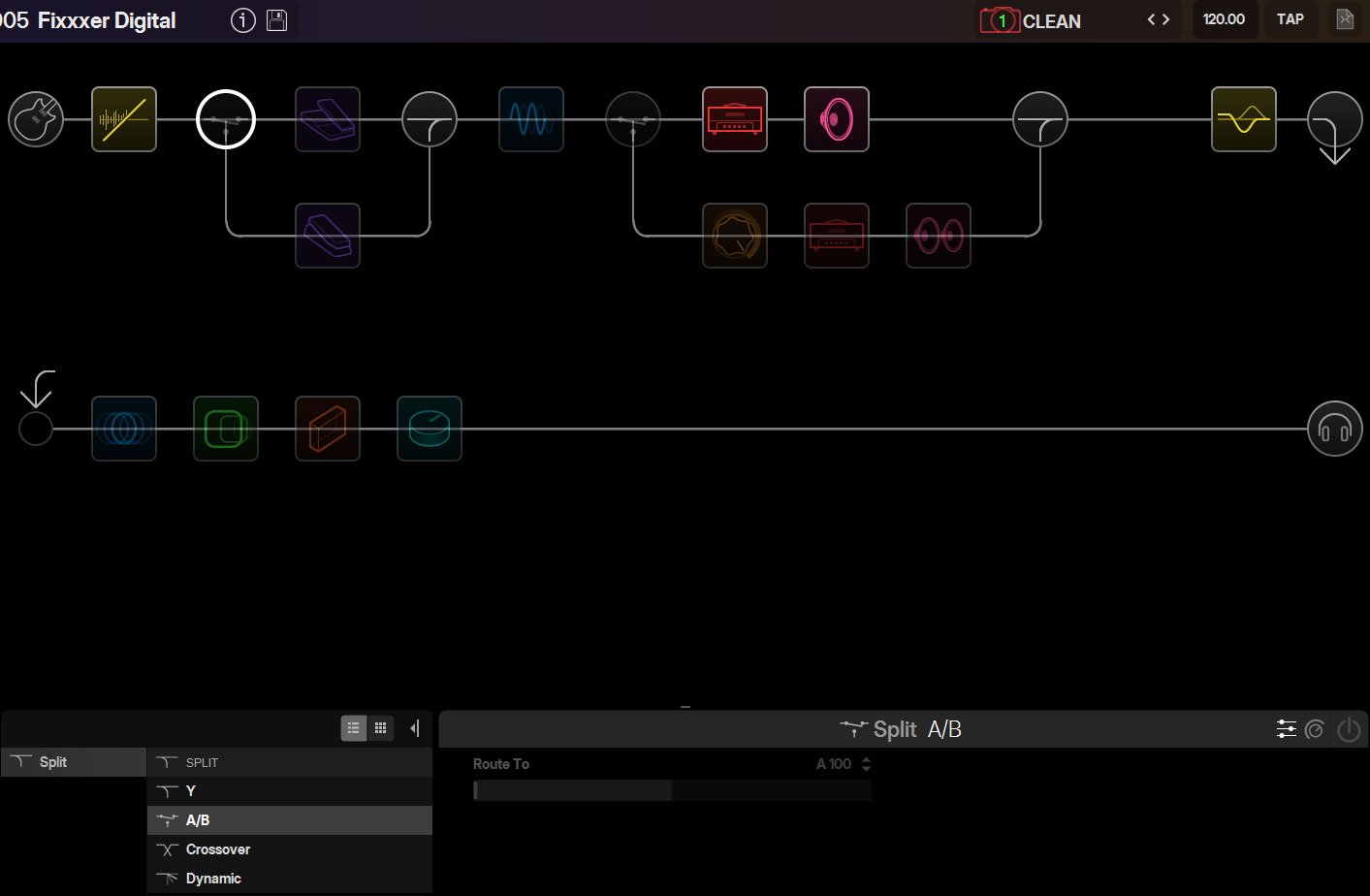

Hi, I think I have found a bug in the setup of the split A/B block on my Helix stadium floor running latest 1.4 firmware. Let me explain. I created a preset called Fixxxer Digital. I have added a split A/B block to split my clean amp (Jazz Rivet 120) and my dirty amp (Cali 2C+). I use snapshots to switch between my clean and distorted amps. On this split A/B block I can save the route to A or B for each snapshot. my 2 CLEAN snapshots have the value set to A100 (clean amp) and my 3 DISTORTION snapshots have the value set to B100 (dirty amp). When I push the buttons of the snapshots I can see the value change between A100 and B100. Now the problem is with the first split A/B block in my signal path. I have create this split A/B block to enable either the wah pedal or whammy pedal effect to be controlled by my external pedal Mission EP-1. (this is a spring loaded expression pedal without toe button, and connected to my stadium floor via TRS cable.) The problem is that I can not program this split A/B block between A100 and B100! If I turn it to A100 and save the snapshot, then it is changed for ALL snapshots! When I set the value to B100 and save the snapshot, the block remains B for all snwpshots! I tried changing the split block to a split Y block, and then changing it again to split A/B, but the problem remains the same. How is this possible? Again, the 2nd split A/B block just before the 2 amps is working fine.
In below image you can see my signal path with 2 A/B split blocks. The split just before both amps works fine, I have the block always enabled and the value changes from A100 to B100 when I press different snapshots. However the first split block before the whammy/wah does not let me save A100 and B100...
