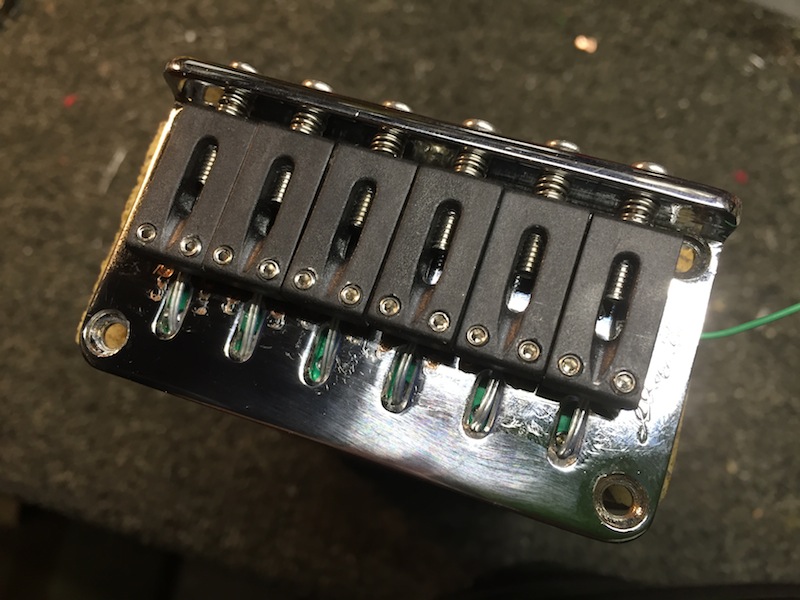

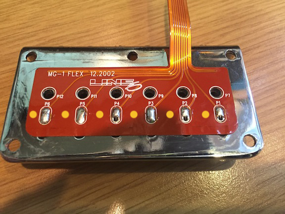

I started out with a stock Variax 500 bridge.

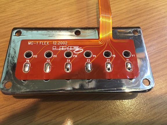

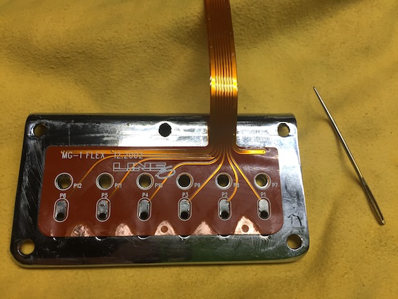

I used an Exacto knife to scrape away the conformal coating to expose the copper ground plane.
With some solder wick, I removed the blobs of solder from the original piezo installation and removed the original saddles.  I used the carpet needle shown in this picture to enlarge the holes just big enough to allow a passthrough for the ghost wires. After enlarging the holes, I used a multi meter to make sure that each pickup signal pad was still isolated from ground.

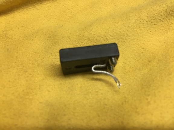

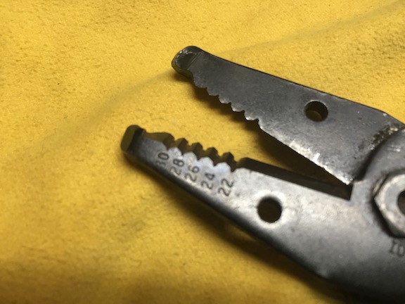

I cut the wires attached to the Ghost saddles at a length of .75" (3/4"), used the Exacto knife to separate the two wires, the silver is the HOT wire and the blue is GROUND. I found that the #28 stripper size on these Ideal strippers was the perfect gauge for prepping the wires. I pre-tinned each of the ends and pre-tinned the pads on the flex circuit. By doing this, very little heat was required to make the final connection. This keeps the insulation from being unnecessarily stressed.

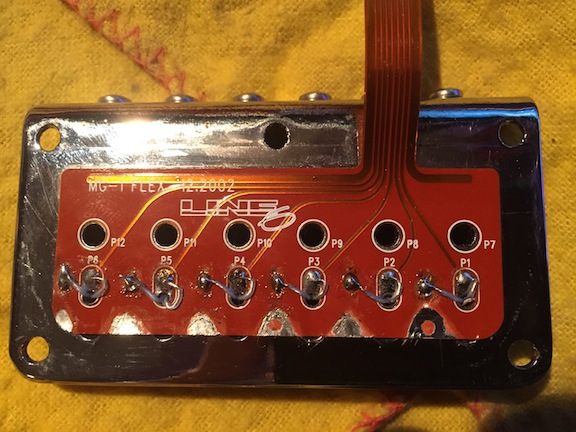

Here is the finished solder job.
And the top view.

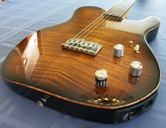

Here is the guitar that this bridge will be installed in. It's a Warmoth body with 500 neck and guts.
When I upgrade the next bridge, I plan to locate the ground connection points as shown in this picture.

Nice job!  You did a better job of the grounding than I did.  I ran mine back to the thick conductor in the top of your photo.  I like your solution better.  You do have to make sure that your guitar body is routed where the wires go so that they don't get pinched between the body and the bridge.  Your guitar is very nice!  I need to do that some day!  Did you have the route the body for the electronics yourself or did you get it that way?
I bought this guitar from someone on eBay who purchased the body from Warmoth while they were still making Variax pre-routed bodies. I think I might be safe with the ground solder points. If there is interference I will probably relocate the ground connection on this bridge as shown in my latest mock-up above.  I'll let you know how the fit goes when the guitar arrives.
I think it would be very easy to slightly route where your grounds are if necessary.  It doesn't have to be very deep.  You want the bridge to sit firmly against the body without putting any pressure on your connections.  If I were to do another, I would do the grounds right where you did I think.
So after test fit, the ground locations were in a bad spot.. Guess I knew that before even trying but I had to try first. I moved the location as I proposed earlier and here is the outcome. Going to perform the installation tomorrow.

If I might ask (never put Graph Techs on a 500/700 - only a 300), how are those ground wires going to connect electrically? It looks like they'll be floating.

I used a Dremel Tool to skim off the conformal coating and exposed the copper ground below.

I meant that I've never put Graph Tech piezos on a Variax 500 or 700 (which use the circuit board in your pictures), but have done it with a 300 (which has a different circuit board).

OH, OK, well the triangle areas that I originally soldered to were scraped off with an xacto knife. The new spots were exposed with a dremel so the were smaller.
Nice job again.  Closer to the center is easier to get clearance under the bridge.  If it doesn't fit without touching, I am sure you can remove a bit of the guitar body with the Dremel.

Here is a picture of the finished guitar. Just a note, on the next one, I will leave the low E string Ghost wiring longer. Maybe more like .85" - 1". I came too close for comfort with not being able to pull that saddle back far enough for proper intonation.

Yes.  There is not a whole lot of room for a service loop.  I left mine a little long and let it go forward in the slot especially on the saddles that I knew would end up further back.

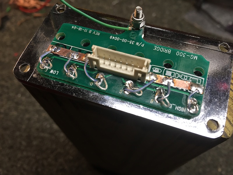

Just a quick update…. I recently purchased a Variax 300 because I got it for a great price. Just took it apart and did the GHOST upgrade and thought I would share a few pictures. Now I have done GHOST saddles on 4 Variax guitars. I found that if you back the saddle all the way, then connect the wire, the service loop is perfect. On this 300 bridge, I used some adhesive copper strip to create the ground plane. There is a small exposed ground area on either side of the 8-pin connector. I folded a tiny amount of copper strip over and soldered the copper to that ground area. Sorry, I didn't get a before picture. I drilled an access hole in the circuit board that lines up with the very front of the slot in the bridge plate to run the wire through. from top to bottom. I hope this helps someone here on the forum. If you have any questions, please feel free to ask.

Re your Variax 300 saddle upgrade. I have decided to repace my original saddles with Ghost saddles from Graphtech.  I have removed the  bridge from the body and I notice that my guitar does not have the Green earth wire (connected to the stud) as on your photo.  Is this extra earthing you have fitted yourself, or is it original wiring that is missing from my equipment?
Oh, and where is the other end of that wire connected?post-2509798-0-56777100-1484860388_thumb.jpg
