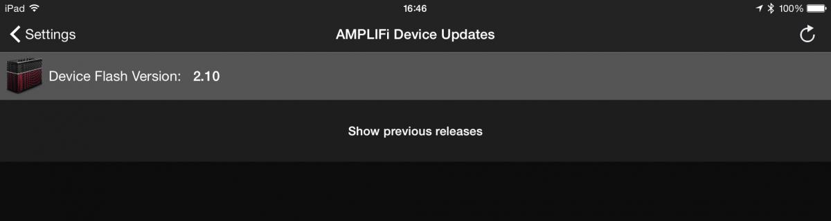

Blahfingers Posted April 16, 2015 Author Share Posted April 16, 2015 How do you re flash once it's at the latest version? I get this screen, but clicking on the refresh button or on the picture of the amp doesn't do anything because it is the latest version. I imagine I might be able to reinstall an older version and then the latest on top of it, but haven't yet tried. Is there some other way to force a re-install? Quote Link to comment Share on other sites More sharing options...
Blahfingers Posted April 16, 2015 Author Share Posted April 16, 2015 Turns out choosing 'previous firmware versions' lets you re-install the latest as well. I tried that, but still have the same problem.... Quote Link to comment Share on other sites More sharing options...
