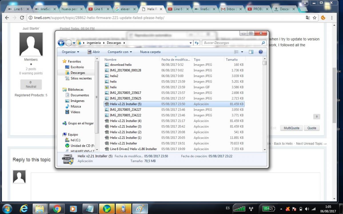

bigcat64 Posted August 6, 2017 Share Posted August 6, 2017 First I try to download several times de Helix v,2.21 installer, my helix version 1.06.5 Says!! boot failure,entered update model when I try to update to version 2.21 , tray again and now shows this screen, , line 6 update does not work, to select device to update, usb helix port does not work, I followed all the instructions !!!! http://youtu.be/Ws8H8ZWybIw 1 Quote Link to comment Share on other sites More sharing options...

bigcat64 Posted August 6, 2017 Author Share Posted August 6, 2017 I try several times from your server to download Helix v2.21 Installer, I follow all the instructions , it seems that the archive was corrupt!!!! I installed the last archive Helix v2.21 Installer (5) and as I said , I followed all the instructiions!!! Quote Link to comment Share on other sites More sharing options...

bigcat64 Posted August 6, 2017 Author Share Posted August 6, 2017 The server seems to be very slow, when i downloaded the arcvhive , my internet connection is 30 MB , the file took more than 50 minutes to, downloading !! Quote Link to comment Share on other sites More sharing options...
DunedinDragon Posted August 6, 2017 Share Posted August 6, 2017 First of all, you need to select the 2.21 update and follow ALL the directions in order and precisely. If you do that you'll notice the first thing you do is to use the Helix application on your PC to back up your patches. Then you download the updated Helix application. The updated Helix application will install the appropriate updater. YOU DON'T DOWNLOAD THE UPDATER. THE INSTALLATION OF THEW UPDATED HELIX APPLICATION DOES THAT FOR YOU. I think the problem you have is a mismatch between the Helix application and the updater. Just follow the directions on the 2.21 release notes precisely and all should go well. Quote Link to comment Share on other sites More sharing options...
bigcat64 Posted August 6, 2017 Author Share Posted August 6, 2017 No, I followed all the instructions, finnaly with this steps is fine now!!! ( this step is from robbieb61 topic from this forum) Turn it off, turn it back on while holding down buttons 6 and 12 (the last buttons on the top and bottom rows). That took me into "Update Mode" ,(the screen was black???) Change the usb cable, it seems problematic ! but now line 6 update shows me my Helix,(Chad Boston Youtube Channel advice) Download the firmware to local update, first downgrade to HELIX_FLOOR_1_06_5_bundle version, then update Helix_FLOOR_v2_21_0_bundle, now in working again with the last version!!! As I said again , I follow all the steps, I Think the problem was the usb cable!! t Too bad the unit comes with such a cable!!!! Quote Link to comment Share on other sites More sharing options...
