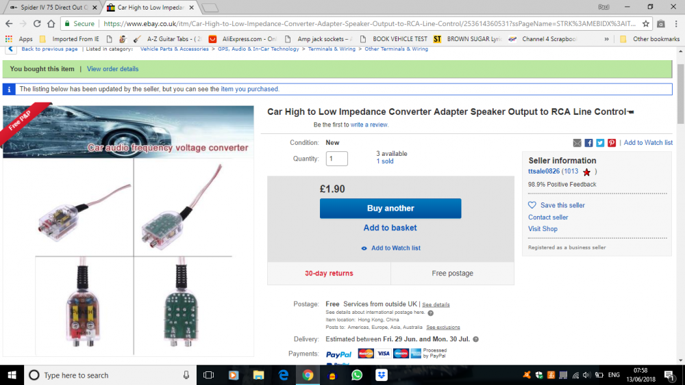

Get one of these.I did this on a spider 3.Hook it up to the speaker leads and then glue it inside the cab.I now have thes speaker running in my spider 3 and a DI feed to a desk
The solution above ^^ is taking the powered speaker output and paralleling it to more devices.  Note that this could affect the amp's output circuit (running a parallel circuit will reduce the impedance seen by the amp circuit).  It's also sending a powered signal to whatever device is being used - this could blow out components in an audio interface or computer's audio input.
Not sure why the OP wants to hook up desktop speakers directly to the DI - the amp's built-in speaker will give the best tone.
This device can be screwed down so its an extremley low unpowered feed into a desk. I been using it on a spider 3 with no adverse affect and its a more true tonal pattern to using the headphone out. Also have my spider 3 altered at the phones port with a flick switch so i can either have the amp speaker on or off which is what I previously used...until I got this converter....streets ahead of the headphone port as a DI,just keep the converter set at minumum
