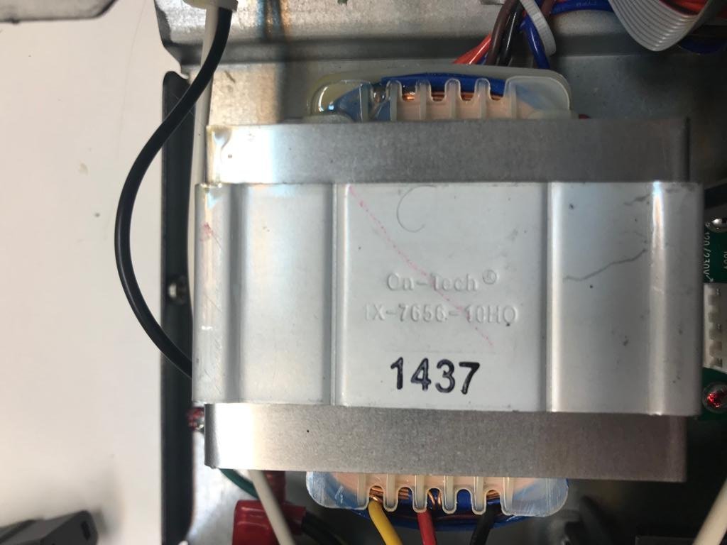

Million thanks for your reply and support my dear friend. I've been using the amp for more than 4 years with a 110 to 220 v  (300w) power transformer without any problem.- Always wanted to replace the original  internal 110 w transformer to don't have to use both. but I was afraid of doing damage to the amplifier being not an official service here in mi country.-
Do you think it can be a transformer problem??? Do you know some transformer datasheet to know if i can replace it for a new one with the same values??? I attach a picture of the converter and the internal transformer.-
Million thanks again
A 120VAC / 220VAC would be closer, since US power transformer primaries are 117-120VAC.
