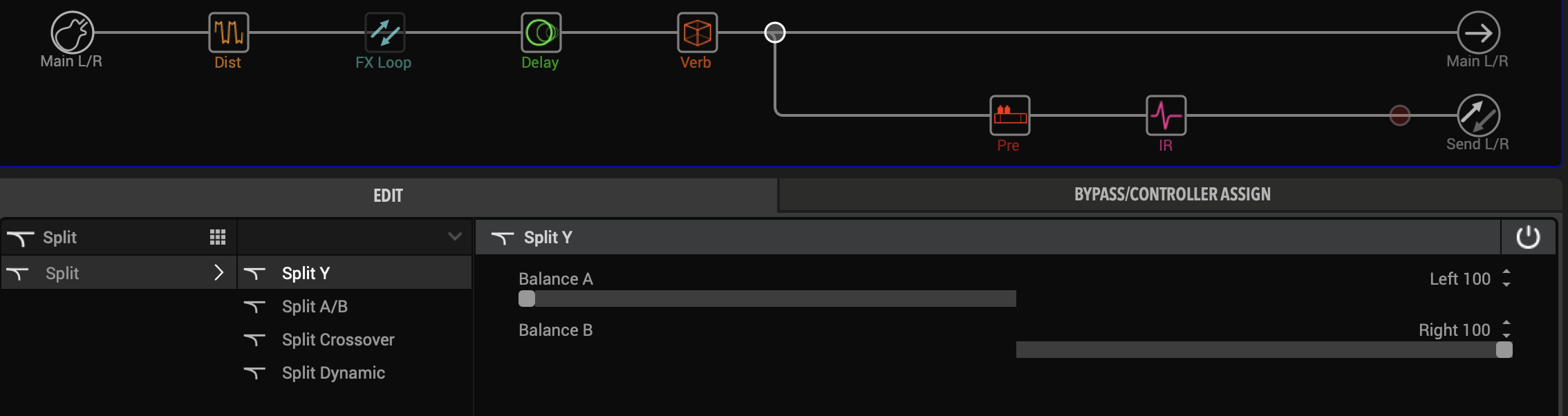

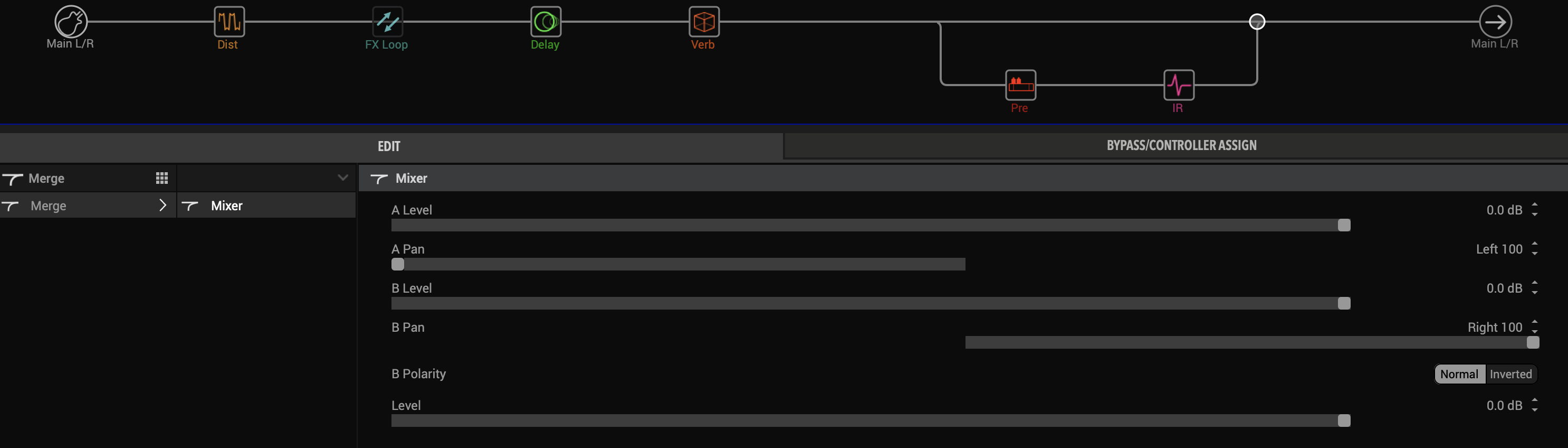

moxybass Posted April 24, 2022 Share Posted April 24, 2022 Stomp Setup with 4CM using method from Line 6 Manual - all sounding great 1/4 jack from output R into DI to FOH - getting nothing What am i doing wrong ? Thanks Quote Link to comment Share on other sites More sharing options...
phil_m Posted April 24, 2022 Share Posted April 24, 2022 You’re not sending any signal to the right side of Path A (the top path) after the split block. It’s looks you should be using the 1/4” Send as your connection to the DI. 1 Quote Link to comment Share on other sites More sharing options...

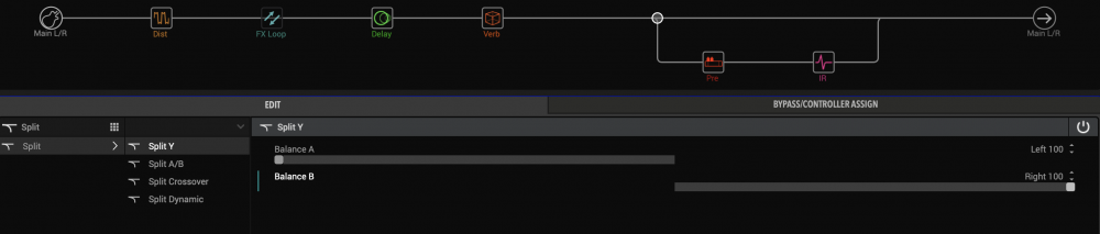

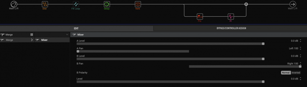

codamedia Posted April 25, 2022 Share Posted April 25, 2022 Merge the path back to the top (after the IR, drag the bottom path to the top path).... then set the "merge block" Pans accordingly. 1 Quote Link to comment Share on other sites More sharing options...
moxybass Posted April 25, 2022 Author Share Posted April 25, 2022 Cheers So is this correct Path A to Amp (Output L) Path B to FoH (Output R) I am connecting output to a passive DI then to mixing desk (FoH) - Stomp to DI use a TS or TRS cable Rehearsal tomorrow evening fingers crossed all good (save me carrying huge amp/cabs around) Thanks Quote Link to comment Share on other sites More sharing options...

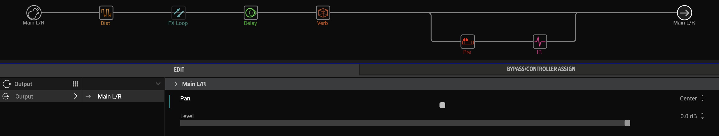

codamedia Posted April 25, 2022 Share Posted April 25, 2022 On 4/25/2022 at 2:16 PM, moxybass said: So is this correct Path A to Amp (Output L) Path B to FoH (Output R) FWIW, I don't think the SPLIT has to pan anything... you should be able to feed both paths equally. Other than that the MERGE looks correct, as does the output block. On 4/25/2022 at 2:16 PM, moxybass said: I am connecting output to a passive DI then to mixing desk (FoH) - Stomp to DI use a TS or TRS cable Stomp to DI should just be a standard cable... TS 1 Quote Link to comment Share on other sites More sharing options...

codamedia Posted April 25, 2022 Share Posted April 25, 2022 @moxybass... I just realized you have the LOOP set up as a 4cm method. Are you running additional effects in that loop, or is it an AMP's preamp. If it is an AMP then can I ask why you are running a "preamp block" prior to the IR. Normally the amp is already serving as a preamp so only the IR block is actually required prior to sending to the FOH. Quote Link to comment Share on other sites More sharing options...
moxybass Posted April 25, 2022 Author Share Posted April 25, 2022 On 4/25/2022 at 10:26 PM, codamedia said: @moxybass... I just realized you have the LOOP set up as a 4cm method. Are you running additional effects in that loop, or is it an AMP's preamp. If it is an AMP then can I ask why you are running a "preamp block" prior to the IR. Normally the amp is already serving as a preamp so only the IR block is actually required prior to sending to the FOH. ah ...... yes i have effects in the fx loop = correct the preamp is not required Quote Link to comment Share on other sites More sharing options...
