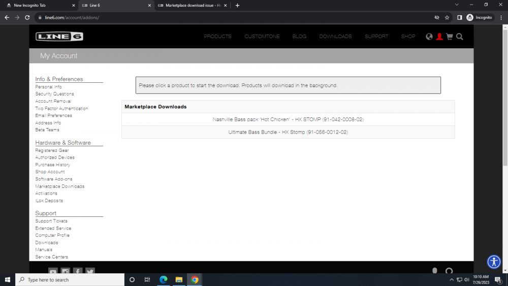

Hey. Thanks for responding. I double checked (Image Attached), and I purchased the correct one. Thanks.
Hi,
Yes. that does look like it is the correct package, but I would still advise contacting the guy who is selling these on Marketplace. It's not impossible that he has mistakenly uploaded the wrong version of the package, or there is something in the file that pushes it over edge of DSP power.
