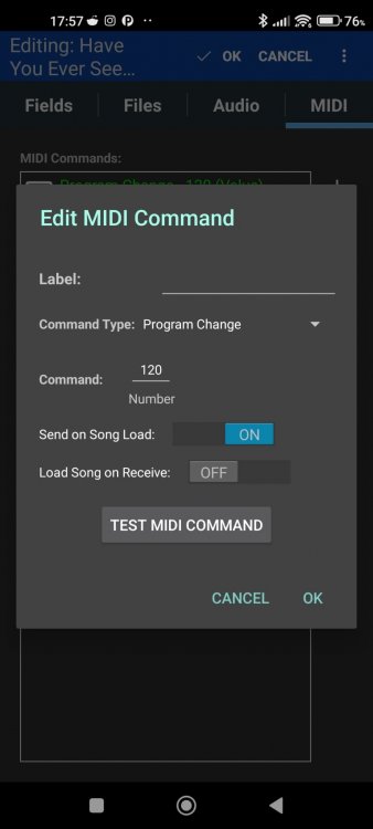

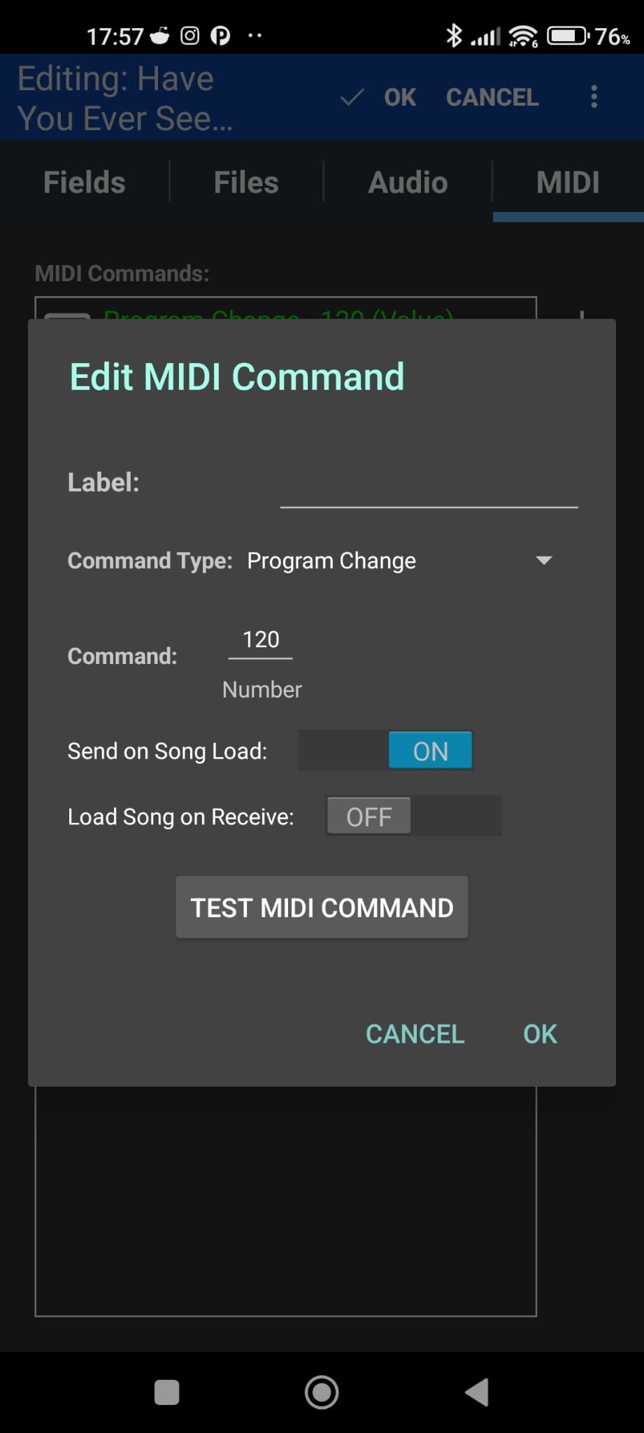

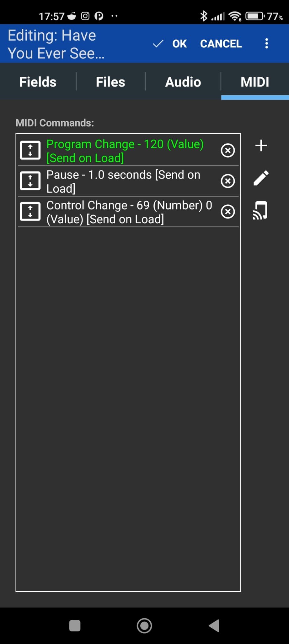

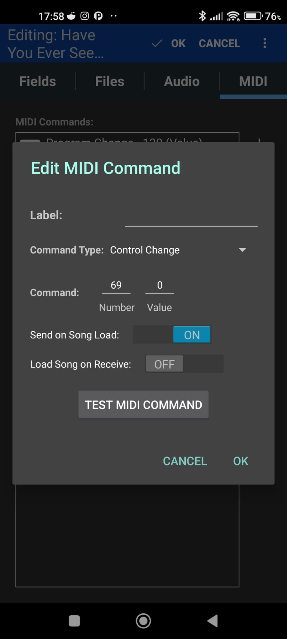

DeArmin Posted February 4, 2025 Author Share Posted February 4, 2025 @Schmalle Sorry, but the commands as they are issued by MS, in order, are correct (s. attaachments) PC - Pause - CC. PC e.g. 120 (for preset no. 120), then pause e.g. 1 second, then CC Number= 69 + Value= 1 (for snapshot 2). When changing presets, the correct SnapShot would then have to be called. In the example snapshot no. 2 The problem is sometimes when changing presets instead of SnapShot 2, SnapShot 1 is called. In the attachments I choose the Snapshot 1! Quote Link to comment Share on other sites More sharing options...
Schmalle Posted February 6, 2025 Share Posted February 6, 2025 On 2/4/2025 at 6:13 PM, DeArmin said: @Schmalle Sorry, but the commands as they are issued by MS, in order, are correct (s. attaachments) PC - Pause - CC. PC e.g. 120 (for preset no. 120), then pause e.g. 1 second, then CC Number= 69 + Value= 1 (for snapshot 2). When changing presets, the correct SnapShot would then have to be called. In the example snapshot no. 2 The problem is sometimes when changing presets instead of SnapShot 2, SnapShot 1 is called. In the attachments I choose the Snapshot 1! Check Global Settings->MIDI/Tempo->Snapshot CC Send : Quote Determines whether HX Stomp automatically sends matching MIDI CC messages (CC69) when selecting Snapshots. This is handy for simultaneously recalling Snapshots on another MIDI-connected Helix or HX device. This option is "Off" by default. Quote Link to comment Share on other sites More sharing options...
