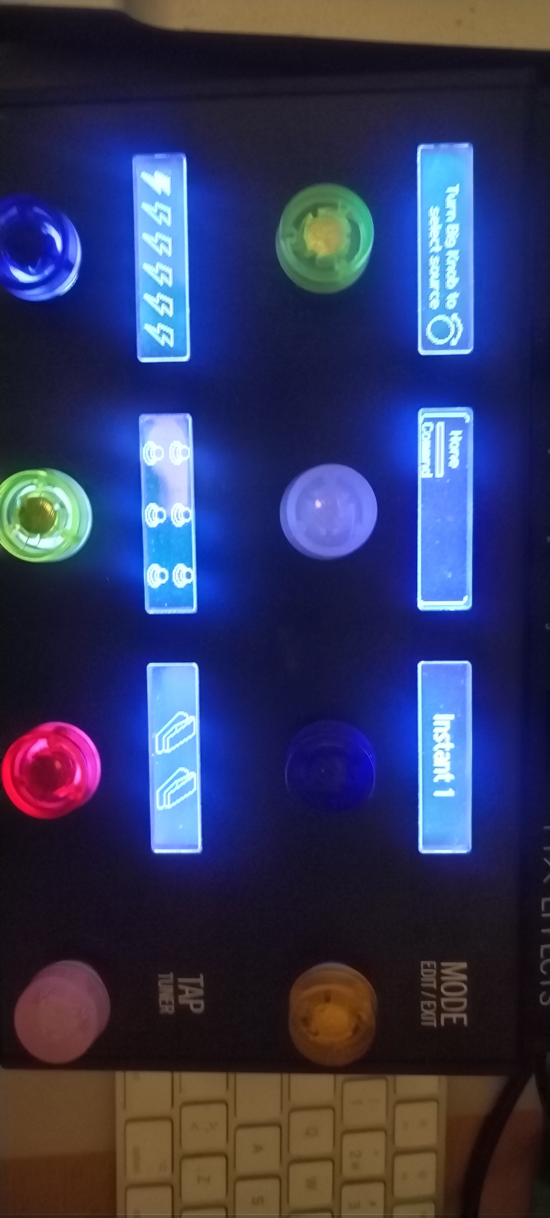

kitaristi3 Posted February 16 Share Posted February 16 I'm trying to control AMP1 via HX's Midi Out. The Midi channel on both units is set to 1 and I disabled USB MIDI, MIDI PC RX, MIDI PC TX and Snapshot CC Send. When I choose the channel, boost etc at AMP1 and press, say patch 1 button at the HX nothing happens except that the Amp1 freezes. That means I have to boot it. I tried the same programming move with Tech 21 Midi Moose controlling the Amp1 and it worked like a dream. Blueguitar informs us that if there's too much Midi-information going on you are surely to experience a failure. What's wrong here? Quote Link to comment Share on other sites More sharing options...

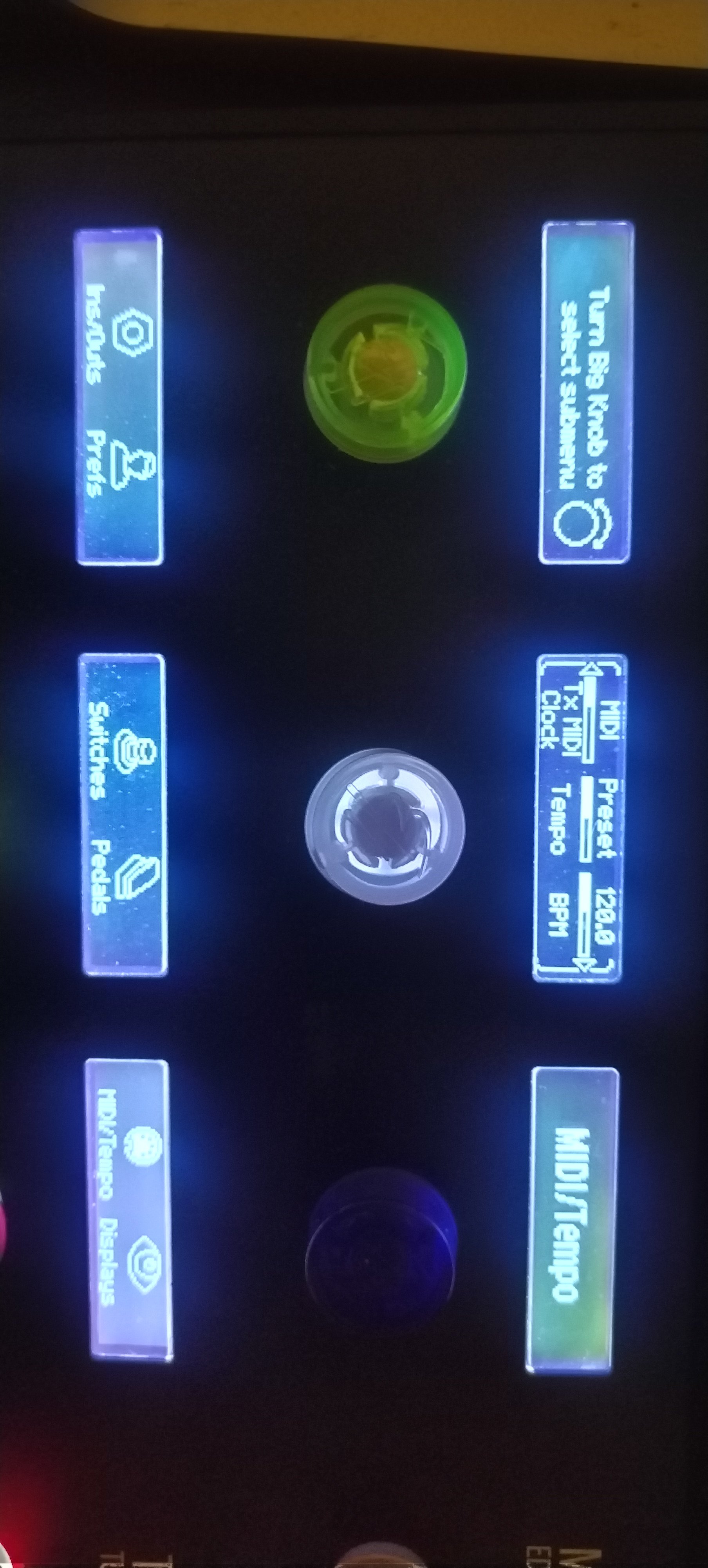

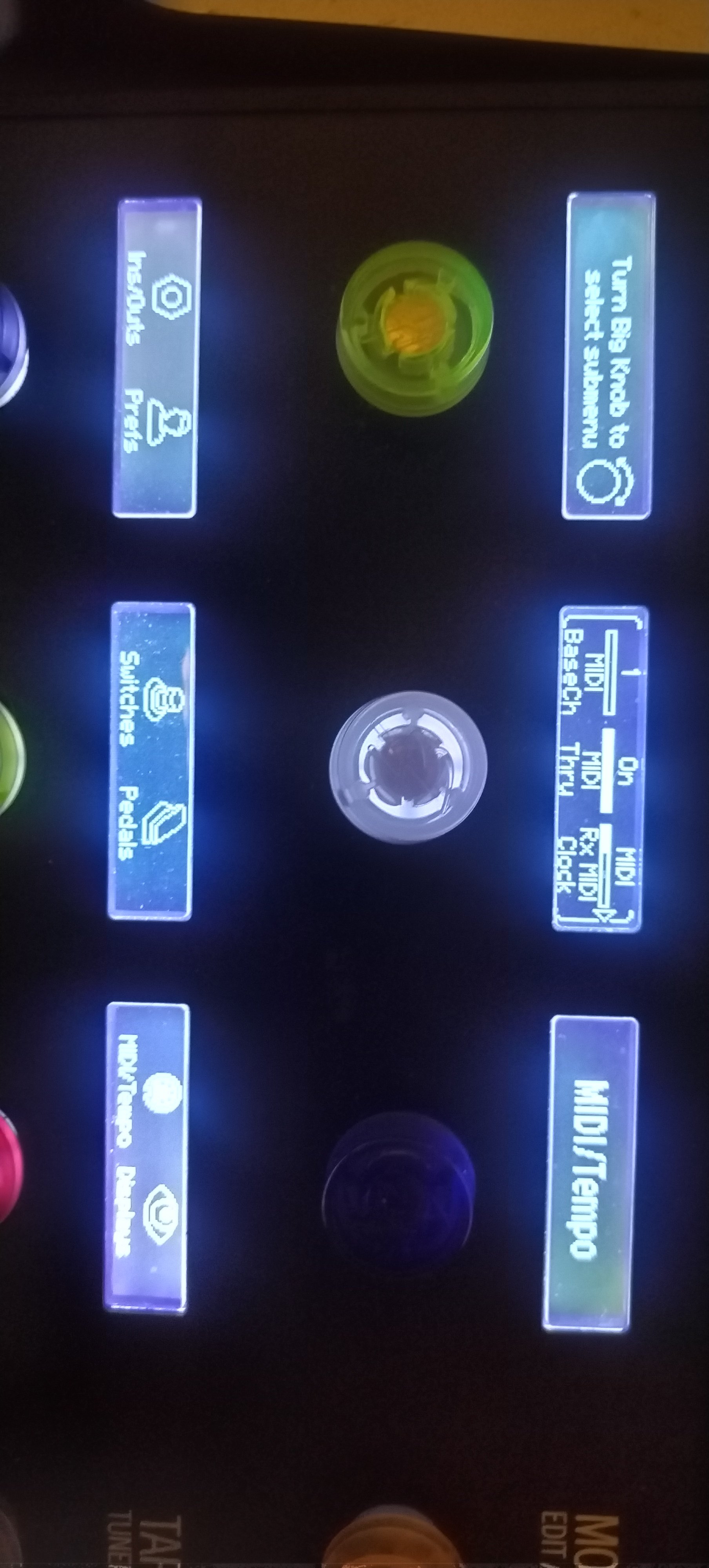

kitaristi3 Posted February 21 Author Share Posted February 21 Hello! Heare are the pics of the preset 01A at power-up. They are from command center and Global settings menus. Quote Link to comment Share on other sites More sharing options...
rd2rk Posted February 21 Share Posted February 21 IDK what that is, but it's NOT the COMMAND CENTER settings. If you don't know what COMMAND CENTER is, that would explain why you're having a problem. Start at page 43 of the HXFX User Manual. Quote Link to comment Share on other sites More sharing options...
kitaristi3 Posted February 21 Author Share Posted February 21 The third picture Is from the command center page after you press the Menu key right after powering on the device. Is it supposed to look different? I've experimented with all the Midi CC, CC Togl, Bank/PC and MMC -controls and options with poor results. I suppose Bank/PC is the solution to my problem but I'll try again tomorrow with the manual;) Cheers! Quote Link to comment Share on other sites More sharing options...

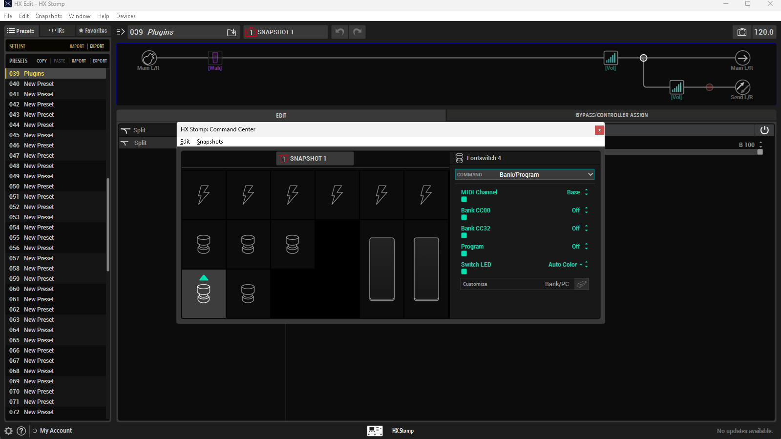

rd2rk Posted February 22 Share Posted February 22 I can't explain the HW interface to you, as I don't have the HXFX. I do know that using CommandCenter in HX Edit is the same for all Helix family devices. Show me your configuration in HX Edit. Here's what it looks like for my HX Stomp. 1 Quote Link to comment Share on other sites More sharing options...
