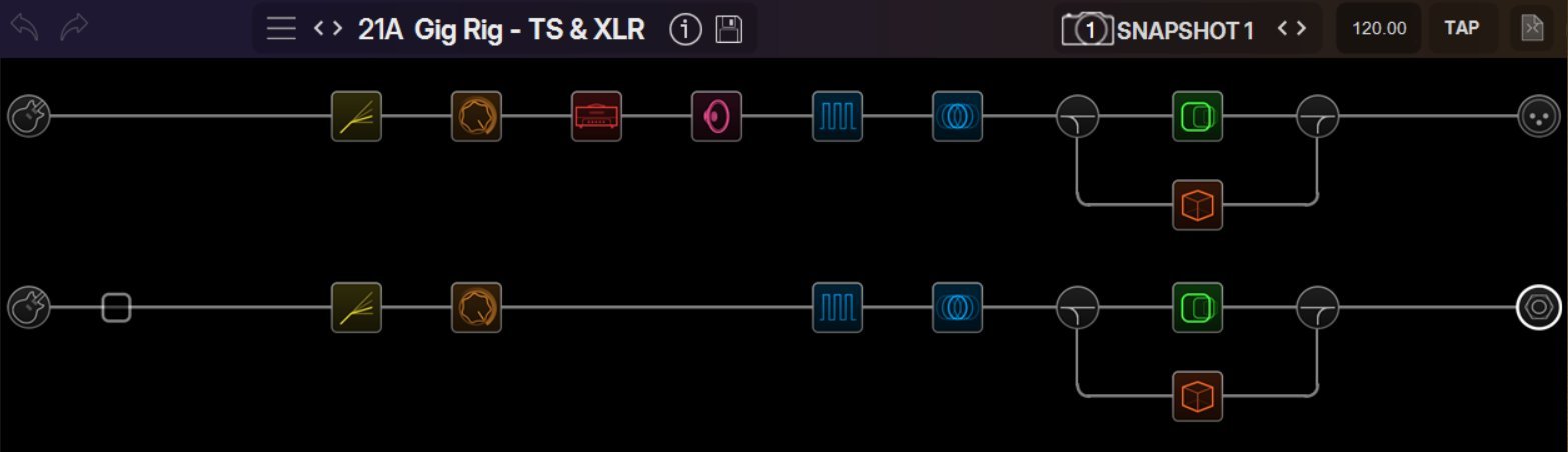

Since you're using backline amps provided by the venue, then I'll guess that you're probably going to keep things simple by running one cable from the Stadium to the amp's 1/4" input (rather than stringing extra cables cables for 4 cable method).  In this case I think the thing to do is to have a preset with two parallel path chains.
In the attached image, Path A is has the output routed to the XLR, so this would be the FOH chain.  It includes Amp and Cab blocks with effects blocks both before and after them.  Path B has the identical effects blocks but it doesn't have an Amp or Cab block.  The output of this path is routed to the 1/4" output, so this chain is sent to the amplifier on stage.
Building path B would simply be a matter of doing a copy 'n paste of the blocks from Path A.  You'll just have to be aware that when you adjust parameters on one of the blocks that you'll need to duplicate the change on the other path (which is a simple copy 'n paste overwrite of the existing block).
Be sure that the output of Path A is "XLR Direct" and Path B is "1/4" Direct".
A stereo signal from Path A can be sent to the FOH by using two XLR cables.  The same stereo effects blocks can be used on Path B because if you use one 1/4" cable out of the L/MONO jack, Stadium will sum both channels to a mono signal.
One thing to keep in mind is that a mono effects block will sum a stereo signal to mono signal, so for whichever blocks are to be stereo, make sure that there aren't any mono blocks downstream from them.  Amp and Cab blocks are mono, so stereo blocks must follow them.
