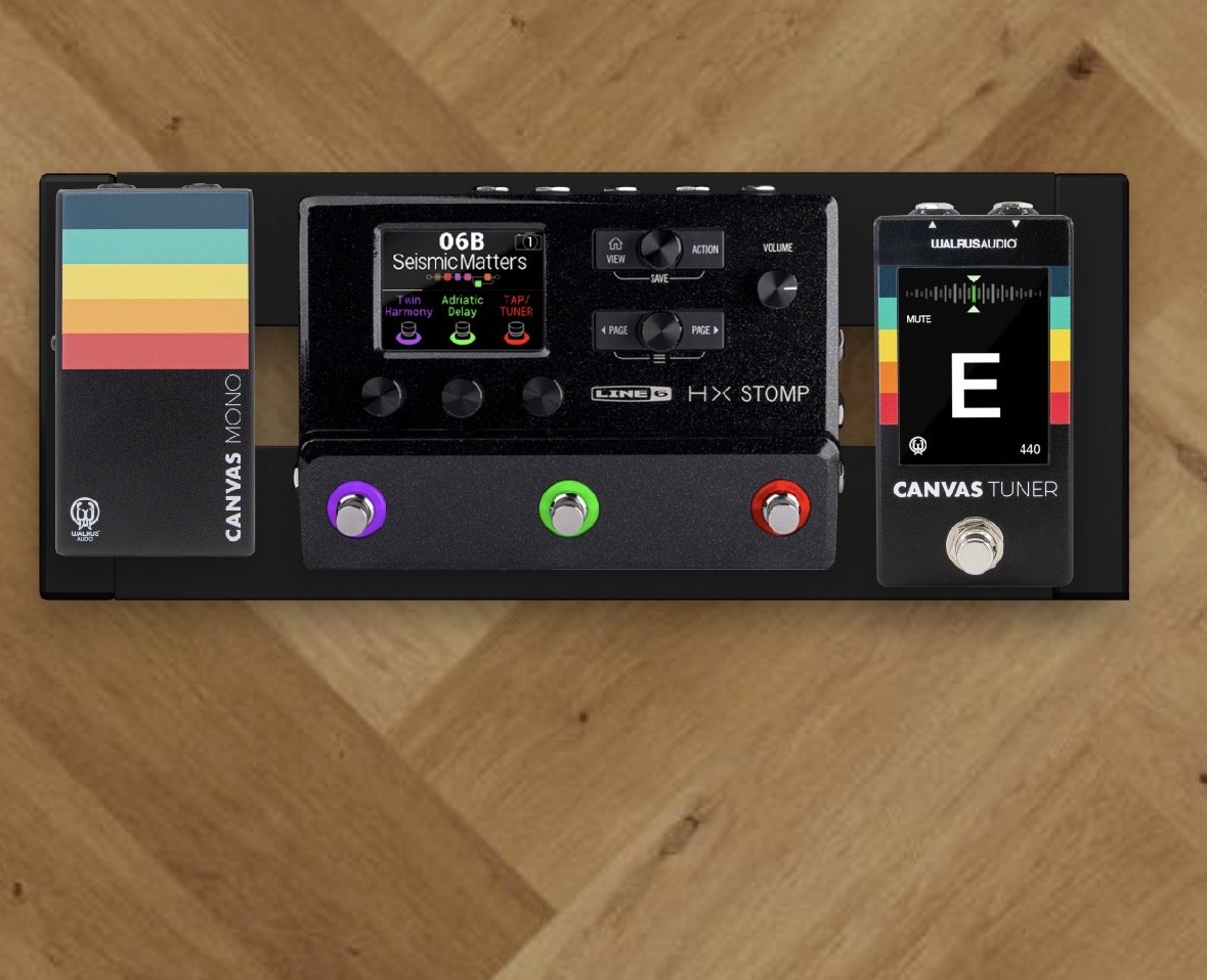

The pic is the setup I’m thinking of using.

Yes to your first post. See manual description of Scroll Mode, and Global Settings -> Footswitches FS3. That’s assuming you want to control both Gain and Delay blocks together. If you want independent control of each then the answer is no.
Second post: too subjective. Only you can decide. Your height? Eyesight? Daytime outside?
On 4/27/2026 at 2:23 PM, Riki1 said:
Also in the screen preset name big enough to read standing up?
The entire HX series IMO has a rather huge visibility issue (one of the reasons I sold my Floor), but for me it's never been worse on the Stomp (which I still own) than it was on the Floor. You rather get used to remembering what's behind a patch number, though.
