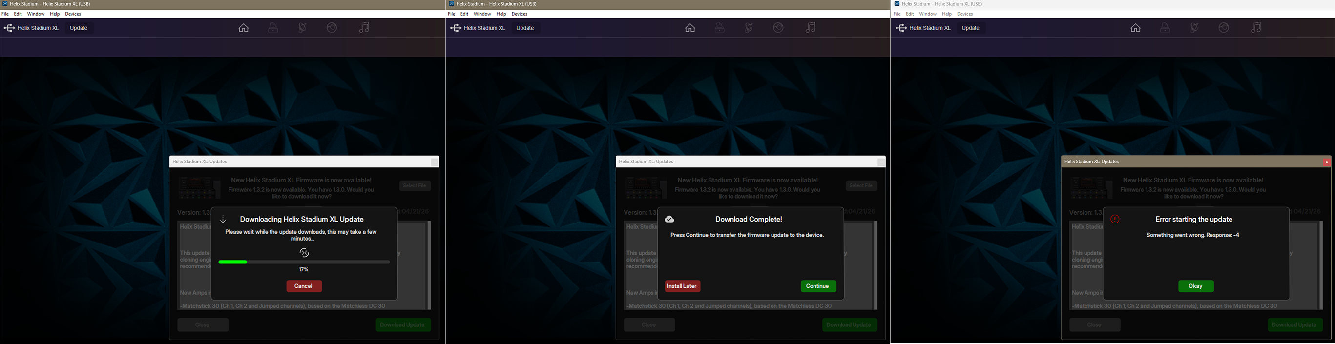

Melodioso Posted June 2 Share Posted June 2 I cannot update the Helix Stadium XL to 1.3.2 and get the following error messages: Wi-Fi: Code -103 USB: Response -4 Line 6 Central: UPDATE FAILED at 0% Are there any workarounds? Thanks. Quote Link to comment Share on other sites More sharing options...

Melodioso Posted June 2 Author Share Posted June 2 Yes, tried via: Wi-Fi USB Line 6 Central Screenshots below: Quote Link to comment Share on other sites More sharing options...
Melodioso Posted June 2 Author Share Posted June 2 I did a full restore (by holding Home & Song button while powering). Same issue. Hopefully this post will be helpful for other people with the same problem. Quote Link to comment Share on other sites More sharing options...
Melodioso Posted June 2 Author Share Posted June 2 It appears that the issue is caused by the download not reaching 100%. It stops before completion and then proceeds with the incomplete downloaded update. Is it possible to update via a file directly? Quote Link to comment Share on other sites More sharing options...
Melodioso Posted June 2 Author Share Posted June 2 Indeed, I finally found out where the file is downloaded using the Line 6 Central app: the file is not complete and the size always varies (17MB, then 54MB, ...). Can someone share the SWU file for 1.3.2 ? I opened a ticket but the support is not useful unfortunately. Quote Link to comment Share on other sites More sharing options...
