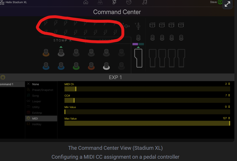

I am trying to control my TONEX Pedal via the STADIUM XL. I am operating in combo mode (Presets on top stomp row / Snapshots on bottom). I want the MIDI signal to change the TONEX bank / channel when I select a different Snapshot.
When I look at the Helix Editor I can only see setting for Stomp A and B, but on my board it shows the Preset and the Snapshots. I have tried assigning the MIDI command to the correct stomp, but nothing happens. Is there a way to show the Snapshot on the stomp in the editor so I know I am assigning the command to the right snapshot?

You could use instant commands on each snapshot:

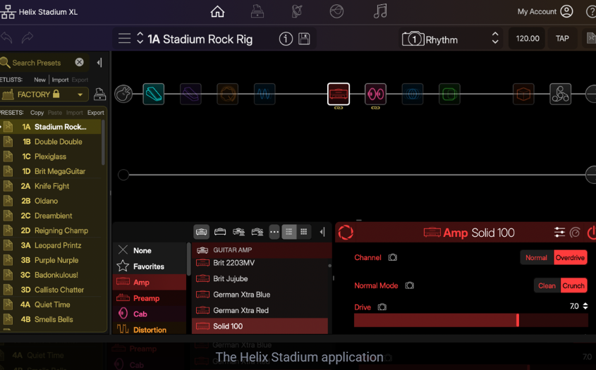

For the snapshot display , it's there (the camera symbol on the top right named "Rhythm" in this template)
