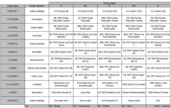

Those are actually correct. Positions 3 and 5 in the Special bank are a different guitar than Position 1 (actually a Les Paul Junior only has one pickup - the bridge, so there wouldn't be anything else to model for the other positions). It's the same thing with the Tele. There's three different guitars in that bank.
Oh, okay thanks! Didn't know that. From the manual, I assumed it's the same models. I still see that the Tele Thinline and the Tele Custom are switched on position 4 and 5. 4 should be Thinline and 5 should be custom as per the chart you posted but it's the other way round. I can change that in workbench.
