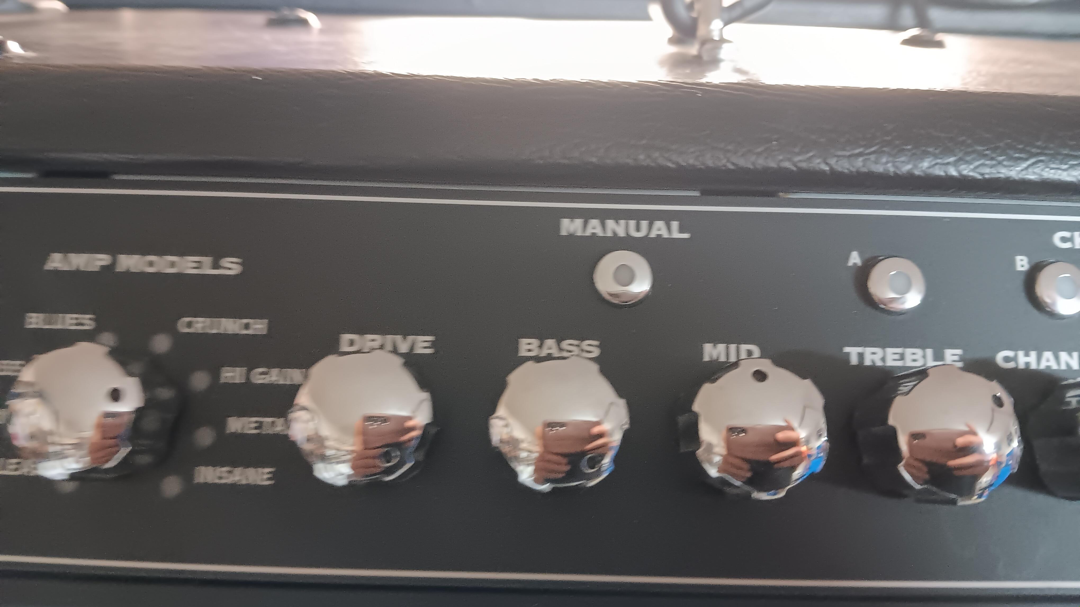

dpsmi Posted yesterday at 04:13 AM Share Posted yesterday at 04:13 AM I had same issue with the weird volume thing going on. Scared me to turn a knob to be honest. Pressing the manual switch overrides the presets and lets you use the knobs to taste. This solved the weird volume issue for me. I get what I expect to get when I turn a knob now. Manual mode worked to solve this for me. No need to factory reset for this fix. My initial problem was when I would turn the amp model knob, the volume would change. Sometimes too high, other times too low. Then it seemed the volume knobs on the channels and master were very unresponsive to the touch or over sensitive. Either way. Manual mode is the fix for me Quote Link to comment Share on other sites More sharing options...
