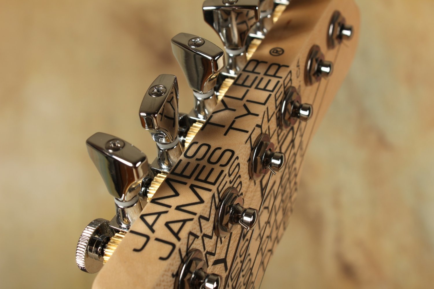

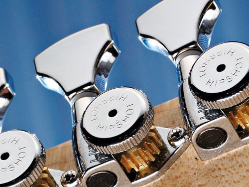

stevekc Posted June 26, 2015 Share Posted June 26, 2015 JTV Variax- Hipshot Staggered height Locking tuners now at Amazon $51 (Same as used on the USA Tyler JTV-69) http://www.amazon.com/gp/product/B00ABLI0IC?psc=1&redirect=true&ref_=oh_aui_detailpage_o00_s00 Quote Link to comment Share on other sites More sharing options...
snhirsch Posted June 27, 2015 Share Posted June 27, 2015 Interesting. Those are markedly different from the tuners on the Korean JTV-69 (Gotoh?). Low E and A are nowhere near as tall and gradient from end to end is shallower. Quote Link to comment Share on other sites More sharing options...

Topaz Posted June 29, 2015 Share Posted June 29, 2015 Great heads up. Didn't even know these staggered things existed. Amazon has good pricing for the tuners with the UMP plate. Unfortunately just for a few left handed tuners for some reason oh fer heavens sake... left handed tuners are for normal right-handed fender style guitars and right tuners are for lefties?? oh crap.... i just noticed the stock 69 tuners are also staggered. DOH! So the Hipshots are even shorter? Quote Link to comment Share on other sites More sharing options...
snhirsch Posted June 30, 2015 Share Posted June 30, 2015 The Korean JTV-69 tuners have a steeper slope from end to end. All posts are noticeably taller than what I infer from that picture above. Considerably so in the case of Low E and A. Quote Link to comment Share on other sites More sharing options...

stevekc Posted June 30, 2015 Author Share Posted June 30, 2015 The locking tuners that came with my 69S are just fine by me. Simple test - next time you remove strings, grab the string binding post on the Korean JTV-69 locking Tuner and twist it back and forth, there exists 5 to 7 degrees of loose backlash. No Backlash on the Hipshot = more stability and ability to return to pitch during / after heavy whammy bar use Quote Link to comment Share on other sites More sharing options...
