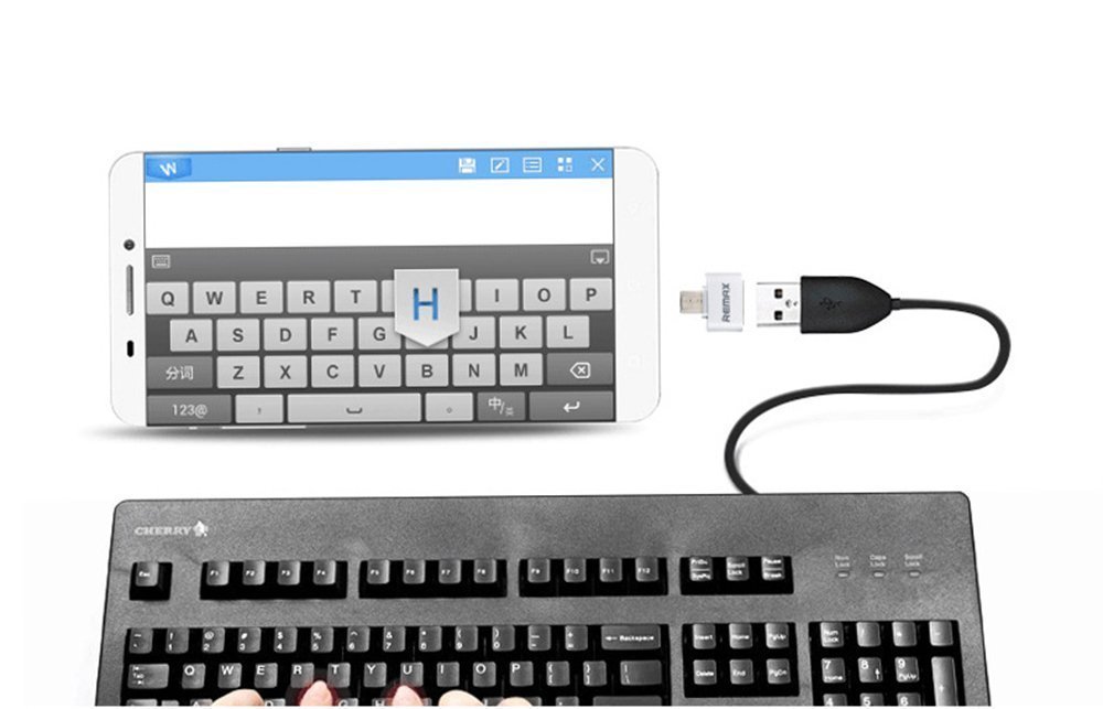

Antmax Posted January 7, 2017 Share Posted January 7, 2017 I just used one of these OTG adapters and a regular cable. Works with all 5/6 android devices I own. http://amzn.to/2iQ6e4L Quote Link to comment Share on other sites More sharing options...
