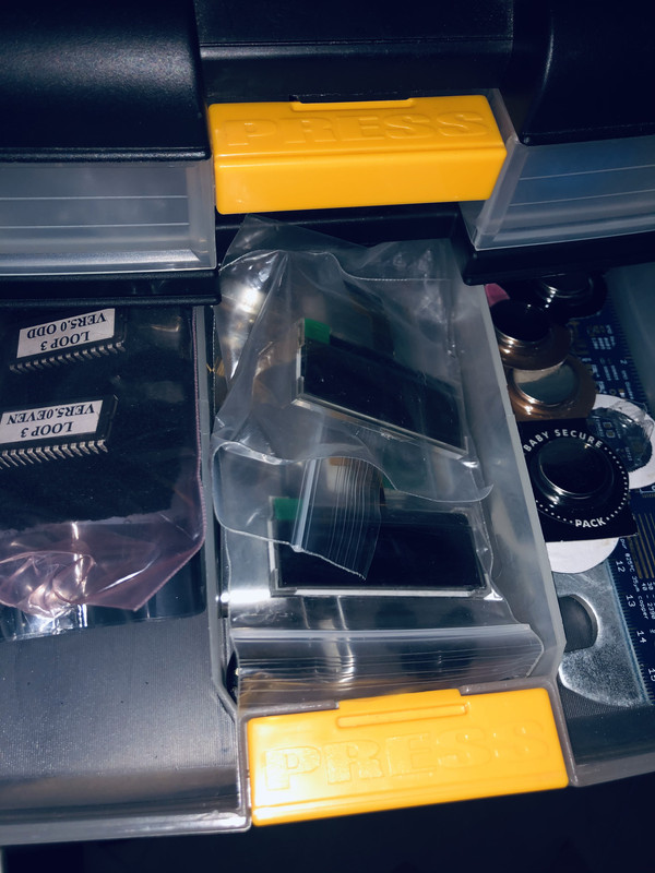

PierM Posted April 25, 2021 Share Posted April 25, 2021 That's why I keep couple of scribble strips replacement in my toolbox lol...(been there, done that) . Jokes apart, contact support. It's hardware related and isnt fixable UI side. Quote Link to comment Share on other sites More sharing options...

PierM Posted April 26, 2021 Share Posted April 26, 2021 If you are out of warranty and you have some bit of experience with electronics, it's an easy fix. You can find the part here: https://britishaudio.com/collections/line-6-parts/products/line-6-helix-effects-footswitch-lcd-display 1 1 Quote Link to comment Share on other sites More sharing options...
MarcoKmz Posted April 26, 2021 Author Share Posted April 26, 2021 Wow, thanks. Are you pretty sure that replacing the display would fix the problem ? Have you already done this fix ? Quote Link to comment Share on other sites More sharing options...
PierM Posted April 26, 2021 Share Posted April 26, 2021 1 hour ago, MarcoKmz said: Wow, thanks. Are you pretty sure that replacing the display would fix the problem ? Have you already done this fix ? Did that twice on my old Helix Floor to fix two scribble strips with same symptoms. (scribble flashing randomly and/or not displaying any data) Before to do that, just contact support and see what they says. I did on my own because Im good with electronics and that was way quicker and cheaper than shipping the unit and wait for the fix. 1 Quote Link to comment Share on other sites More sharing options...
