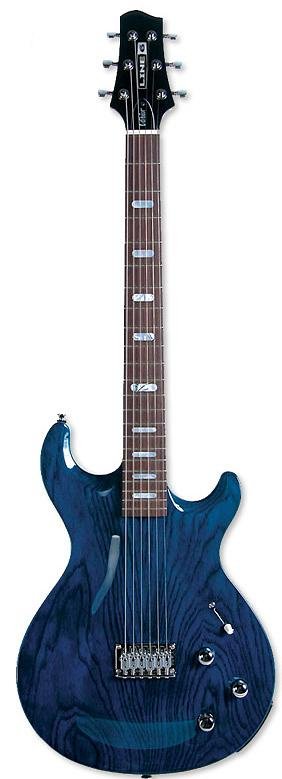

Variax 700 Electric
Hello, everyone,
My Variax 700 Electric modeler has a Piezo pickup on a string that has a somewhat lower volume than the others.
Is there a way to change the volume of the individual Piezo pickups on this instrument, please?
Thank you for your help, in adavance!
