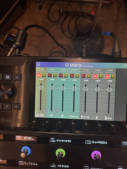

AZGuitar Posted Tuesday at 10:51 PM Share Posted Tuesday at 10:51 PM I had my 2nd Sunday service with my Stadium and it was awesome. Only thing I came across was when I activated the tuner, it did not mute my XLR out. My only on the fly choice was to set the tuner to mute which left me only the visual. I did not see any other tuner options in Global settings or in the Matrix. On my OG, I could see it and hear my unprocessed guitar and XLR to FOH was muted. Appreciate any help. Quote Link to comment Share on other sites More sharing options...

AZGuitar Posted 23 hours ago Author Share Posted 23 hours ago On 12/10/2025 at 1:29 AM, jpdennis said: AZGuitar, Which output were you expecting? In ears only, FRFR, or ?? I have yet to check my setup though I know you can send the tuner to a specific output. I just don't have an image of your routing. I'll be in my studio tomorrow and see what can be done or not done. Thanks for bringing this up. jpd On 12/10/2025 at 6:37 AM, silverhead said: Are you hearing your unprocessed guitar through a non-XLR output/monitor? I presume you don't mean that you are just hearing the natural string vibrations because you are still able to hear that with Stadium. If it's a specific output, is it available for selection in the 'Specific Output' options list? EDIT: I just noticed the post by jpdennis, after I posted the above. Forgive my redundancy. When I activate the tuner I have signal going to FOH via XLR unless I set the tuner to mute which mutes all out puts. On the PG, I could still hear my unprocessed guitar in my IEM's but the XLR send was muted. I would think Stadium would behave the same. It was nice to tune and play the riff prior to countdown regardless if my guitar was hot to house. Thanks for looking into this. Quote Link to comment Share on other sites More sharing options...
AZGuitar Posted 18 hours ago Author Share Posted 18 hours ago On 12/10/2025 at 6:37 AM, silverhead said: Are you hearing your unprocessed guitar through a non-XLR output/monitor? I presume you don't mean that you are just hearing the natural string vibrations because you are still able to hear that with Stadium. If it's a specific output, is it available for selection in the 'Specific Output' options list? EDIT: I just noticed the post by jpdennis, after I posted the above. Forgive my redundancy. My work around for now is to reach down and open the Matrix, mute my XLR channel, engage tuner, exit tuner, open the Matrix again and unmute. Gotta be a better way right? Ontario?...Jason S? Anyway, appreciate you responding. Quote Link to comment Share on other sites More sharing options...

jpdennis Posted 12 hours ago Share Posted 12 hours ago On 12/10/2025 at 3:49 PM, AZGuitar said: My work around for now is to reach down and open the Matrix, mute my XLR channel, engage tuner, exit tuner, open the Matrix again and unmute. Gotta be a better way right? Ontario?...Jason S? Anyway, appreciate you responding. I connected the send 1 from my Stadium to the input for a stage monitor I have on hand. I set the FX loop 1 output to instrument because line level was too loud. Then I set the output for the tuner to send 1. When I used the tuner there is no output to FOH and the monitor gave me my ""on stage" audio. Adjusting the level output on the monitor, I was able to have a very controlled output volume to listen to my tuning as well as if I wanted to "test" a part without going through the board. If you have something like a Behringer EUROLIVE B105D (or smaller) and a On-Stage SSAS7000B it could be a solution for about $150.00 without having to bend over. Just a thought. jpd 2 Quote Link to comment Share on other sites More sharing options...
