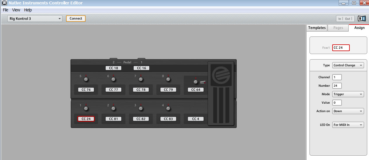

see anything glaring here
I only use HXN as a DAW plugin only, so can't be of much help if you're using as an on-the-fly software instrument. But I'd guess it should work, though, and it sounds like it works with Cubase per TexLefty.
That said, I did manage to make it work pretty quickly using Logic Pro's mapping capability via it's Smart Controls (see screen shot). Reaper may do the same sort of thing... you basically map a plug-in-parametr to a controller. Logic uses a Learn function.
Is this sort of thing any help: https://www.youtube.com/watch?v=MGDsNhodc7Q

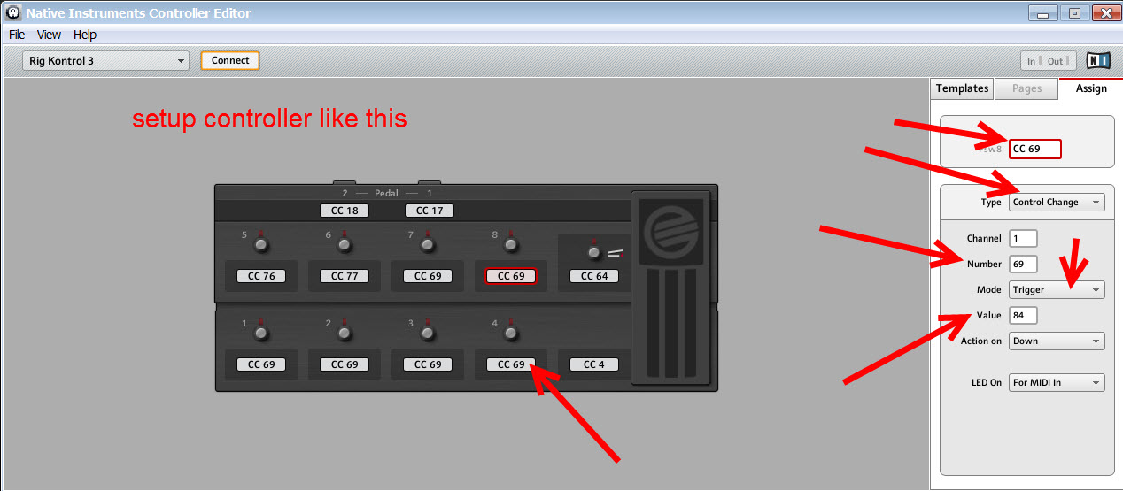

From what I can tell you're setting things up right your CC is set to 24 instead of 69 in your screen shots. Change the Value (to, say, 2 for example) to try changing Snapshots. BUT ... if you're mapping in the DAW via a Learn function, any CC and value should work ...you're just mapping that control # and value to a snapshot.
CC69 is what the hardware Helix devices use for Snapshot selection so it makes sense for compatibility that Native uses this too

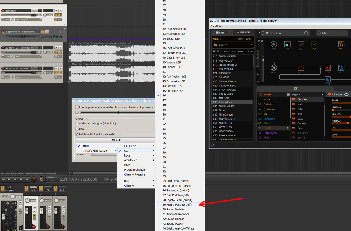

Hi Guys thanks much as you can see in pic - 69 has a designation given by reaper so not sure thats the answer also I tried a lot of different numbers - have to go thru your explanation more tonight :)
