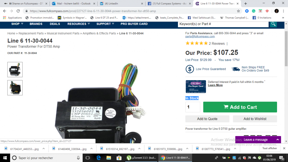

as I live in Algeria I didn't find anywhere to buy a transformer for my DT50. A friend of mine who was on vacation in the U.S.A bought for me the transformer on fullcompass as it is the only website where I could find it available. Once he gave me the package,  bad surprise. As you can seeon the pictures, the part seems used and damaged. Not only that, it has the same problem as my transformer inside my DT,  it  has a short cut in the primary section. Fullcompass does not ship out of USA,  so even if I find a way to send them back the product, which will coast the price of the transformer, I dont have any way to get a new one as I live in Algeria. This story makes me hate my amp

They are still in stock on my browser ...I read a lot of dissatisfied clients
I understand why now !! it leaves me with a dead amp, 2 dead transformers, and money spent !
