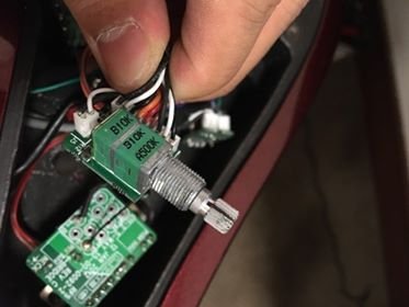

just right now while i was practicing, my guitar's volume knob decided to turn past its limit, and now it wouldnt make any sound.
so i checked under the hood to see what kind of vol pot it has so that i'll just order one for replacement.
the problem now is that i can't seem to find any replacement parts for this at any online shop.
and i'm working overseas for me to take it to any service center.
please help me line 6, i'm really panicking right now because this is the only guitar i have here to keep me sane from this lockdown.
i'm attaching the pots for reference

it's this part... (pic for ref)
the pot shaft (red) against the inner knob (blue)
and it doesnt function, tried it all night.

its rotating (blue part) all the way 360° without stopping unlike a normal vol pot

so far what i’ve been able to find out with the pot is...
Series: 9mm dual metal shaft, multi-ganged series
shaft length: 20mm
Connection: 9 pin/leg
Resistance: nominal b10k, nominal b10k, a500k
Alpha Model: Alpha RD923DF series (possibly)
is this correct?
