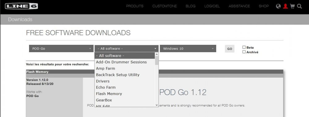

bLietaer Posted September 25, 2020 Author Share Posted September 25, 2020 OK, great thanks! But not sure how these drivers are labeled under the Line6 download page ? (Nothing such as 'asio' :/ ) Sorry to be so lame... Quote Link to comment Share on other sites More sharing options...
cristt Posted September 25, 2020 Share Posted September 25, 2020 should be in the "pod go driver" (that is "line6 driver2") package. Quote Link to comment Share on other sites More sharing options...
bLietaer Posted September 25, 2020 Author Share Posted September 25, 2020 Ah, crap.... :/ I already installed that one long time ago and I can't see any *.exe GUI Tool (except the Uninstaller) where I could fine-tune a buffer/latency setting... :/ I guess/hope I don't have to go and hack *.dll or *.cat flat files manually, right ? Quote Link to comment Share on other sites More sharing options...
cristt Posted September 25, 2020 Share Posted September 25, 2020 I don't think there's such thing as exe GUI, at least not visible on the installer...first off you should see if in your audio devices pod go shows up, and/or if you open up your DAW (for example Reaper) on the audio devices you should find pod go, from there you also open the asio driver tweak panel. of course have your pod go connected. Quote Link to comment Share on other sites More sharing options...
bLietaer Posted September 25, 2020 Author Share Posted September 25, 2020 Yup (and thank you not giving up on me), that's what I understand while re-re-re-reading the POD GO manual: the POD GO driver pop-up GUI is indeed to be called from a DAW SW. So ....we need such a SW. Bummer. I think ProTools went for free with my RackEleven....never needed/installed thought: will try. (And thus my 2 cents life-improvement: I wish the referenced "POD GO ASIO Driver" advertised from the POD GO manual PDF would actually be labeled "POD GO ASIO Driver" in the download zone page drop down menu :/ ) Quote Link to comment Share on other sites More sharing options...
cristt Posted September 25, 2020 Share Posted September 25, 2020 ProTools would be a solid choice. If no luck, give Reaper a shot, it's a free completely functional trial, and trial never expires, but actually buying the license is quite cheap. Quote (And thus my 2 cents life-improvement: I wish the referenced "POD GO ASIO Driver" advertised from the POD GO manual PDF would actually be labeled "POD GO ASIO Driver" in the download zone page drop down menu :/ ) indeed... Quote Link to comment Share on other sites More sharing options...
