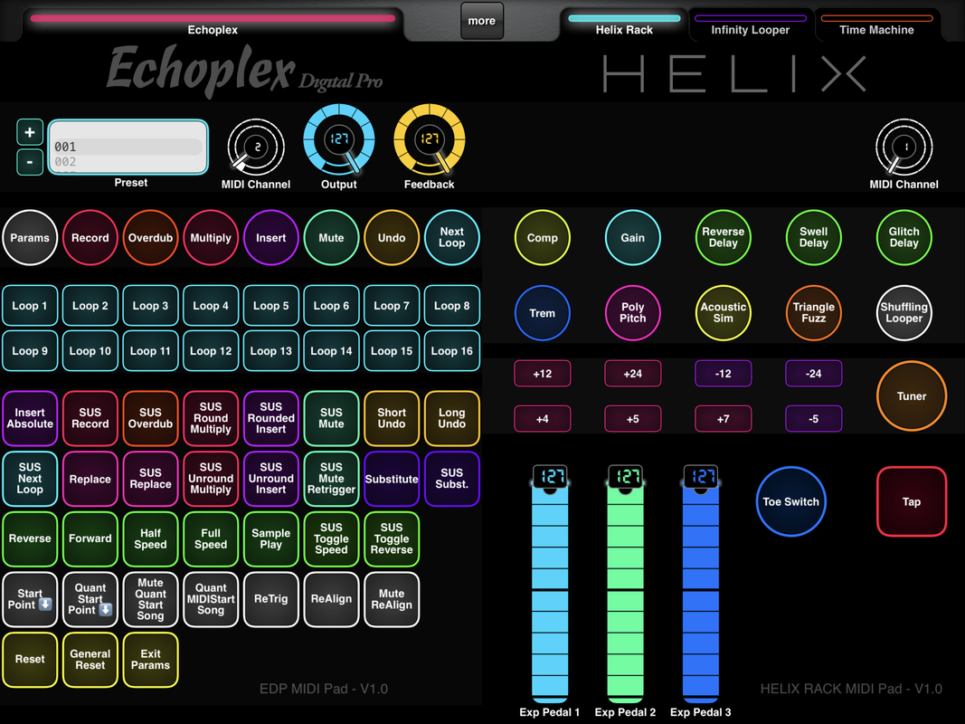

PierM Posted January 20, 2021 Share Posted January 20, 2021 6 hours ago, headabovewater said: ok, that sucks that it wont work. i dont have the money for a helixcontrol lol. i do have a line 6 m13 that has midi out could i use that? Nope. M13 has even more limits, as you can't generate a midi map to talk with the expected values from the Helix...You can just send CCs that are "hardcoded" to the M13 effects. If you have an iPad or iPhone, you could create a cheap MIDI controller with Midi Designer Pro. You have to swap snapshots with hands, but would do the job. This is mine (right side), that I did to control my rack, when I dont bring the control with me. (circles are footswitch, rectangles are snapshots) Quote Link to comment Share on other sites More sharing options...
