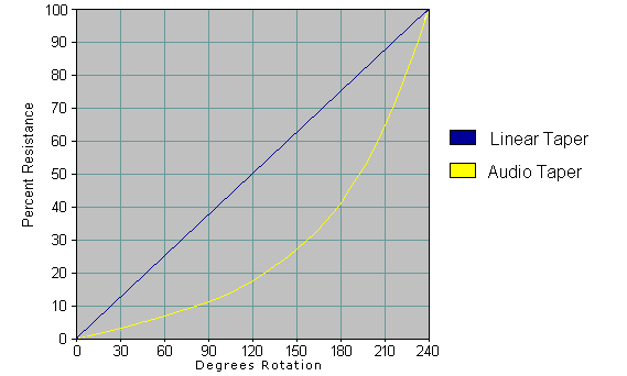

Sounds like you have a bad linear taper pot for volume (or a bad audio taper pot, or a mix with modern wiring which doesnt help), which for their construction they let bleed the signal to ground linearly (resistance ramps up too quickly for our volume perception), while human sound pressure perception works better in Log. Linear are good for tone pots, annoying for volume pots, especially for people playing live at high volumes.
You can improve that aspect wiring a good 250k CTS audio taper for volume, and wiring volume, caps and tone pots with '50 wiring.
* Audio Taper = LOG
