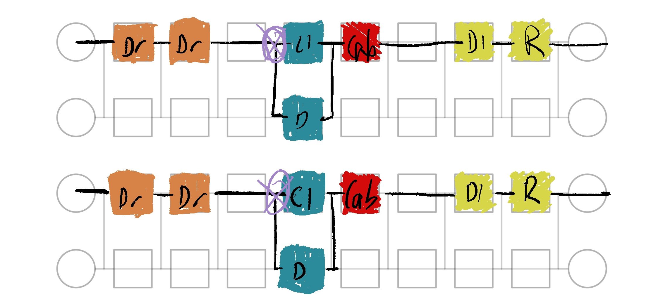

benriddell Posted February 17, 2025 Share Posted February 17, 2025 Obvious answer is to use snapshots to switch the Ev Panama and other amp a clean and distorted setting and stick with only two amp blocks If you really need to use a clean amp (ie. Fender) then Path 1A-1B / Path 2A-2B is the best option using snapshots to control the flow of the signal from the A & B line (instead of switching amp blocks on and off which can cause noise/pops). You'd be best to utilise the same cab and effects blocks across your clean/dirty sound and only have the path split handle the amp - using two amps on one DSP chip will have you rethinking which effects blocks to use though Quote Link to comment Share on other sites More sharing options...

benriddell Posted February 17, 2025 Share Posted February 17, 2025 Something like this, where the direction of signal flow at the purple circle is controlled by snapshots Quote Link to comment Share on other sites More sharing options...

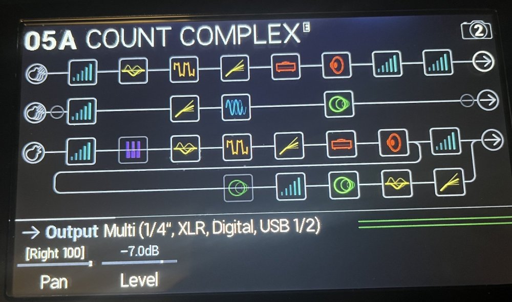

Vanderdecker Posted February 18, 2025 Author Share Posted February 18, 2025 So I tried every trick I could to use a 3rd amp, but the dsp wall was impregnable no matter how hard I tried moving the paths/connections. And swapping amp settings didn't sound great either. I ended up using the 3 parallel method and completely dropped the amp out of the 2nd path entirely(because there wasn't enogh dsp for any with this config!). I have included an image of what I ended up with below. The distortion sounds awesome and the clean is acceptable, but not awesome. I am still looking for a better solution. Maybe I need to accept that I may need two different presets to get the ideal tone for both, then how to switch senselessly is the new issue. Anyway if anyone has more suggestions please let me know! Thanks Quote Link to comment Share on other sites More sharing options...
benriddell Posted February 19, 2025 Share Posted February 19, 2025 I maybe being thick or tired - you've got three separate/indepent paths, correct? Why the two gain/volume blocks on the top row at the end? (although they take up minimal DSP) What's the second row doing? (is that your "clean" path) Do you need both delays / volume/gain / EQ / dynamic blocks after the cab in the third row? If your second line is the clean, stick a "pre-amp" and an IR block in there if have the DSP. That'll be better than a unamped sound Quote Link to comment Share on other sites More sharing options...

Vanderdecker Posted February 19, 2025 Author Share Posted February 19, 2025 I haven't tried IRs yet, but that is an interesting possibility. Yes, First row is distortion right 2nd is clean 3rd/4th row is distortion left, with a bunch of attributes to make it distinct. The two volume blocks at the end of the 1st row: 1 is expression pedal volume and the other is an adjustment to help separate the guitars. But as you said they use almost no dsp. The greyed out delay in the 3rd/4th row is a test block and not needed, but since all my dsp issues are in the top two I didn't bother removing it. All the rest are used. All the volume blocks at the beginning are for switching seamlessly as mentioned previously. Quote Link to comment Share on other sites More sharing options...
