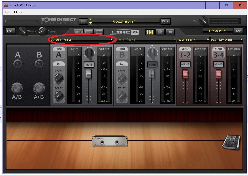

Triryche 2,610 Posted October 21, 2016 In POD Farm standalone mixer view select mic. If you are using the plug-in thru a DAW you will need to select mic in the Line6 Audio-MIDI control panel. Please see the manual for further reference. Quote Share this post Link to post Share on other sites

Jacky817 1 Posted November 13, 2017 Woohoo finally found it as well! No thanks to dude389. Many thanks to Triryche. Here's a screenshot for anyone else who had the problem. Double click the mixer at the end of your virtual pedal chain, then: 1 Quote Share this post Link to post Share on other sites
Jayscu 0 Posted December 5, 2017 Woohoo finally found it as well! No thanks to dude389. Many thanks to Triryche. Here's a screenshot for anyone else who had the problem. Double click the mixer at the end of your virtual pedal chain, then: Capture.JPG Thank you!!! It was so simple Quote Share this post Link to post Share on other sites

AndrewSpence 0 Posted February 4, 2018 I managed to sort it, Wish I had read Jascu post - I finally found out! BUT now I want to go back to electric guitar input and it wont let me. I have adjusted input to line 1 and it does not work.. crazy. Quote Share this post Link to post Share on other sites
AndrewSpence 0 Posted February 4, 2018 Just found it!! Dont click line 1 or line 2.. click INSTRUMENT! Quote Share this post Link to post Share on other sites
