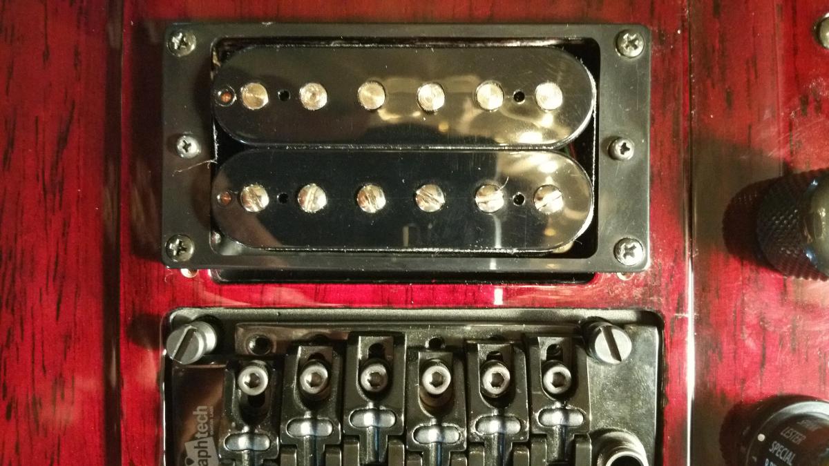

Is there room on the JTV 89F to install a Roland GK3 PUP between the bridge and pickup mounting ring? If not is there a replacement pickup mounting ring that will increase the space to allow the GK3 to be mounted?
No, ...you'll have to make room. I had to move the bridge pickup about 1/4" toward the neck to install it. Well worth it!

Not sure if I have the surgical skills to pull off what you did, so I thought I'd just check; if you could cut away the skinny bit of the bridge-pickup mounting ring that's closest to the bridge, would that make just enough room to squeeze the GK-3 in? From looking at the pics you've posted, it looks to me that it just might.. would be great if I could get the actual measurements :-).
Also good to hear that it tracks well - on the Strat, for example, the GK3 can be fitted so that it's just pretty close to the saddles (which Roland recommends as ideal for good tracking); and here with the Floyd being mounted the way it is, it looked like there would be a fair distance between the string-saddle point and the GK3.

I don’t use a GK pickup on my JTV89F anymore, but I used a conversion pickup ring I bought on eBay to mount the GK3 with zero permanent modification. You just replace the bridge humbucker mounting ring with it and it gives you the clearance and a flat mounting space that doesn’t contact the guitar body. You may want to look into fabricating one yourself with a sheet of metal or plastic.
I have been using a GK3 on my JTV89F for about 3 years with no issues. I just trimmed the backside of the rear pickup ring  and this gives just enough room to install the pickup. In my case I epoxied the pickup to the edges of the ring to eliminate any movement or shifting. (I have 6 guitars of all types with GK3's installed) Has worked great.
Continuing this subject - A few years ago I bought a special mounting plate kit for mounting the GK-3 mic on Floyd Rose-style equipped guitars which have a gap too narrow between the humbucker pickup holder and the bridge, just like on the JTV-89F. However I stowed it away as I had another GK-equipped guitar. Today I decided to use the kit to mount the GK-3 on my JTV-89F.
The idea/procedure is to replace the pickup holder with the special mounting plate, on which also the GK-3 mic is attached. The hex mic is almost shoehorned in, with only a millimetre space on each side towards the humbucker and the bridge. As I prefer pretty low action, the string height over the GK-3 were barely adjustable to the prescribed 1 mm height. However the action and playability remains very good.
The GK-3 box is attached by double-adhesive tape, as the supplied mounting plate is too big to fit behind the tremolo bridge.
The kit seems to be available here: https://www.ebay.com/itm/230382219884
The procedure is easy and straightforward and there are no harm done to the guitar as the plate utilize the existing screw holes for the pickup holder. The images below shows  the result.
