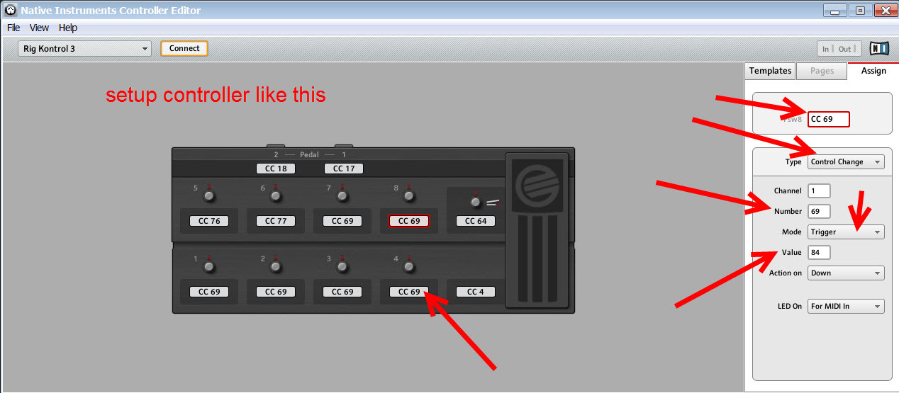

rsvette12 68 Posted December 17, 2018 I just hit midi learn button in studio one then move a pedal or a switch on my rig kontrol then in helix native I move a slider or right mouse click learn on say a wah program I have and it knows what to do - I havent documented how it works exactly because it just worked I need to try fresh over and over to see how its exactly working - I didnt pay attention because it worked so easily in studio one - in reaper not easy for me anyway - I can show you screenshot of rig controller editor see below I think this is the base setup before you start trying to setup a daw notice the midi numbers - I am not good with all this stuff like others here but I know this will get you in the right direction - go for the rig kontrol 3 before you cant anymore - surprised there is a few still available - they rock You also have to make sure control editor is running first in background before entering DAW or board wont work Quote Share this post Link to post Share on other sites
rsvette12 68 Posted December 17, 2018 If you buy one of these we get into more detail about those values there is a different value for each switch - let me know and I will help you out - notice value 84 (BUTTON 4) above that value will be intervals of 16 - meaning the button before this one has a value of 52 (BUTTON 3) Quote Share this post Link to post Share on other sites

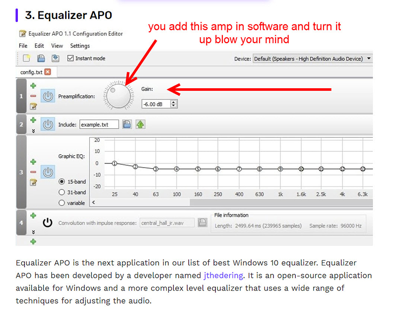

rsvette12 68 Posted December 17, 2018 Also one other thing this is for windows and its amazing makes your onboard sound card like its on steroids - its amazing and free - this helps huge - maybe there is something like it for a mac search around - sound was very low with no oomf boring with this I could add an amp and a bunch of other stuff to play with even with my headphone amps I use this :) Quote Share this post Link to post Share on other sites
rsvette12 68 Posted December 17, 2018 Mac stuff here - i would load some up and see if it helps - should Go to youtube and put this into search window Equalizer APO for mac Quote Share this post Link to post Share on other sites

rsvette12 68 Posted December 17, 2018 This is what I meant by amplification with free apo software - works great but you need something like this for a Mac - must be something Quote Share this post Link to post Share on other sites
Petes63Strat 8 Posted December 17, 2018 Yes! I have been wanting to find a way to address the tinny sound of my otherwise great headphones when monitoring my DAW. It all sounds pretty good through my trusty NS10 monitors and power amp but thin and lifeless through the headphone jack on my Scarlett audio unit. I will start looking for an app solution. Is the headphone output from the RK3 pretty good? Your Corvette is spectacular! That's the perfect color combo in my opinion. I still have my all black C6 Z51 3LT from '08. 30K miles so its still like new and I don't drive it enough to justify the bump. I meant to mention earlier that Soundog also helped me out a lot. Your right. There are some great people here that are willing to pitch in and help out. Thanks again. I'll keep you posted. Quote Share this post Link to post Share on other sites
