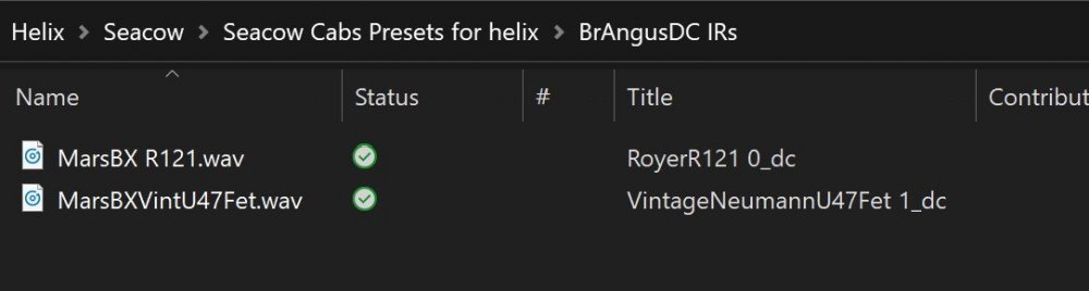

LMychajluk Posted November 25, 2019 Share Posted November 25, 2019 I'm still kind of new to the Helix, but was just trying to download a few Presets and IRs and ran into a snag (2, actually). 1) It seems that the Preset references the IRs by Slot Number rather than name. So, if you have a Preset and load the IR into a slot that doesn't match the original slot on the creator's Helix, you have to 'fix' it. Is there any way to change this? 2) When importing an IR, the name being imported doesn't always match the FileName. It actually seems to me that it matches the Title property of the file. I'm guessing if someone creates an IR called ABC.wav, it set the Title of the file to ABC. Then, if they edit it and save it as XYZ.wav, it changes the filename, but not the Title of the file, which is still 'ABC' (see attached pic for a real example). At least, that's the only reason I can think of for why this may happen. Any way around this, short of renaming the IRs after they've been imported? I'd like to import ~25-30 IRs that are part of a bundle w/ Presets from Seacow that I'd like to check out, and it's already a PITA to go back and re-link them to the associated Presets (See #1 above). Any easier way to manage this? . Thanks in advance! -Lee Quote Link to comment Share on other sites More sharing options...

LMychajluk Posted November 27, 2019 Author Share Posted November 27, 2019 Thanks, guys... Looks like I'm basically going to have to do it manually. Meaning I need to rename the Titles of files back to the Filenames, de-dupe, then import the IRs, then Import the Presets one by one and figure out which IR(s) are supposed to be assigned to what and fix them manually. Once they're all in, I can take a backup, but that will only work for me. I can't share that backup w/o it overwriting other people's current settings. Quote Link to comment Share on other sites More sharing options...
