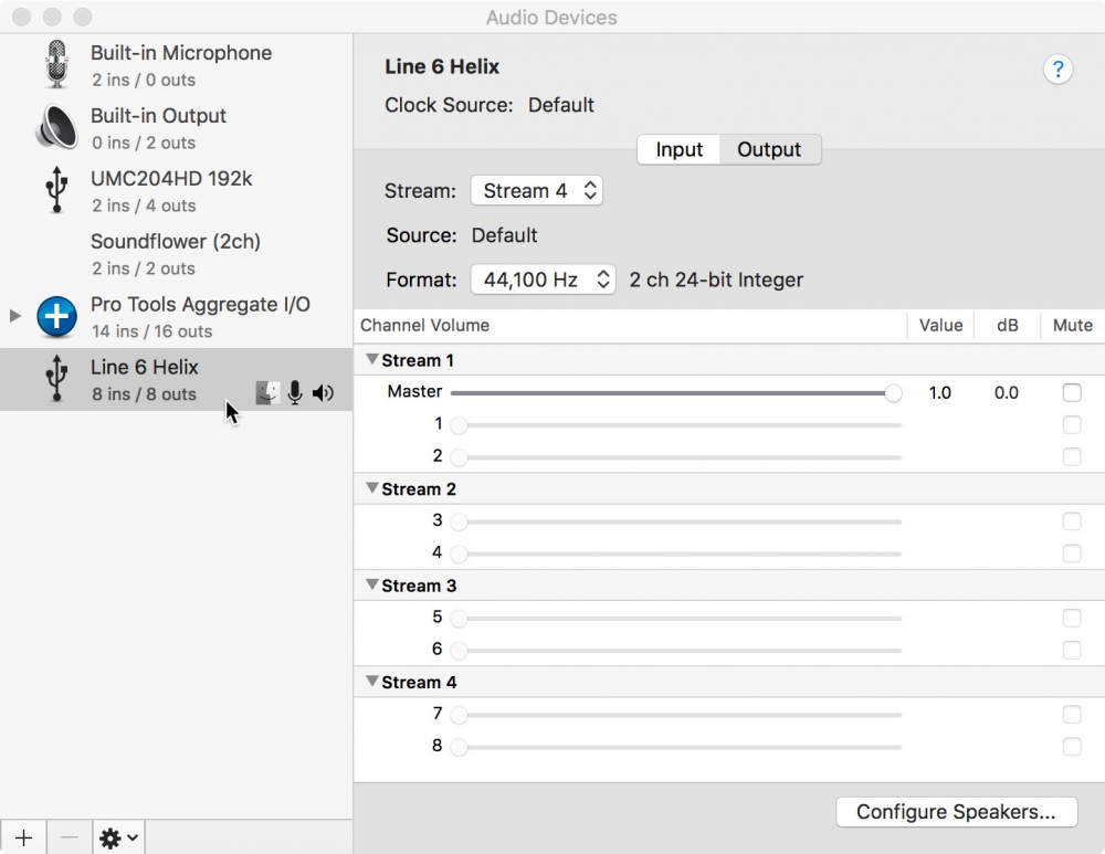

Core Audio Driver Settings (macOS only)
To use POD Go as an audio interface for Mac applications, it is not necessary to install any additional driver. POD Go will utilize the Mac computer's class compliant USB driver automatically simply by connecting to your USB port. POD Go will then appear as a selectable Core Audio device within the Mac Utilities > Audio MIDI Setup panel and/or directly within your DAW host and multimedia applications. Note that this Apple class compliant driver offers strictly 48kHz native sample rate operation.
I don't have this installed on a Mac, but it should look something like this:
