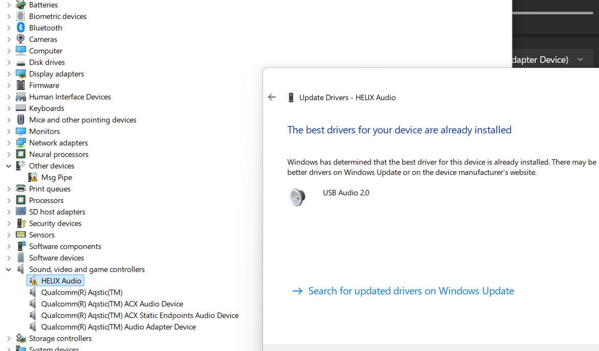

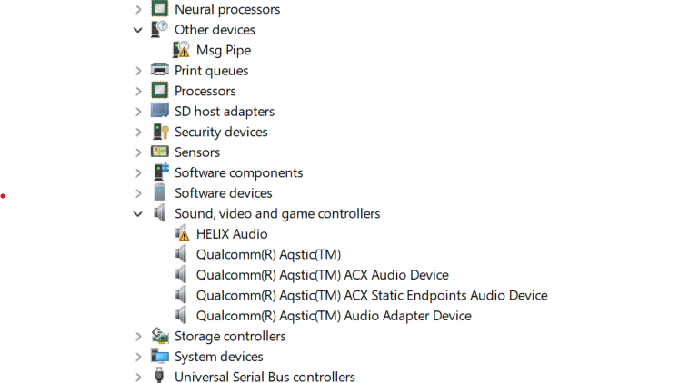

themetallikid Posted November 29, 2025 Author Share Posted November 29, 2025 From troubleshooting with help from TGP as well, I think I know what the problem is, I cannot get it to recognize Helix as an audio device. I have installed the drivers (windows says the Windows USB 2.0 driver is the best for this device when choosing Helix Audio in the device manager). When I go into the sound settings and try and choose the output device I have 'speakers' only. I do not get any other options. When I have device manager up and plug in the USB cord to Helix, I see these two items pop up. The 'other devices - Msg Pipe' and Helix Audio. I have updated the driver automatically and get the message that drivers are up to date, when I manually try and choose the driver from the windows>program files>line6>folders where the drivers install to, it tells me the Windows USB Audio 2.0 'best driver for your device is already installed'. I think thats the issue, but I dont know how to correct that. Quote Link to comment Share on other sites More sharing options...

rd2rk Posted November 29, 2025 Share Posted November 29, 2025 On 11/29/2025 at 7:54 AM, themetallikid said: From troubleshooting with help from TGP as well, I think I know what the problem is, I cannot get it to recognize Helix as an audio device. I have installed the drivers (windows says the Windows USB 2.0 driver is the best for this device when choosing Helix Audio in the device manager). When I go into the sound settings and try and choose the output device I have 'speakers' only. I do not get any other options. When I have device manager up and plug in the USB cord to Helix, I see these two items pop up. The 'other devices - Msg Pipe' and Helix Audio. I have updated the driver automatically and get the message that drivers are up to date, when I manually try and choose the driver from the windows>program files>line6>folders where the drivers install to, it tells me the Windows USB Audio 2.0 'best driver for your device is already installed'. I think thats the issue, but I dont know how to correct that. Never seen any of that. Quote Link to comment Share on other sites More sharing options...

rd2rk Posted November 30, 2025 Share Posted November 30, 2025 On 11/29/2025 at 7:52 PM, themetallikid said: Your saying to uninstall/reinstall which driver the Helix? or the USB 2.0 audio one that windows seems to favor for everything? I'm saying to uninstall/ re-install everything Line 6, BUT... I had a little more time to look at your screenshot of your Device Settings. Before I make any other suggestions, a couple of questions: What is your Lenovo's FULL model #? Processor model? When you got it, did you perform ALL of the available Windows updates? That means rebooting and re-checking Windows Updates until there were no more updates to install on two or more successive reboots? Did you then install all of your other (non Line 6) applications? What applications did you install? Are you backing up all of the relevant (to those applications) data directories to OneDrive or elsewhere in the cloud? Are you using ANY antivirus/malware programs other than Windows Defender? Did you uninstall whatever crapware that the Lenovo came with pre-installed? A screenshot(s) of your Startup settings - SETTINGS>APPS>STARTUP - could be helpful here. I know, that's a lot of questions and you might not understand why they are relevant, but there is no logical explanation for why a brand new Win11 system should be as hosed as yours seems to be, and before I make any further suggestions I need to know these things so that I don't make things worse. TBH - depending upon your answers to the above, my best advice MIGHT be to restore it to the condition it was in when you took it out of the box, then come back for advice on how to proceed. But that could be painful and very time consuming. I've been using Windows since before there was Windows (DOS) and if it's not necessary... 1 Quote Link to comment Share on other sites More sharing options...

rd2rk Posted December 1, 2025 Share Posted December 1, 2025 I'm suspecting that both windows update and HXEdit are having a problem with that processor. After uninstalling all Line6 drivers and HXEdit, try turning OFF Core Isolation: Settings>Privacy&Security>Device Security>Core Isolation Details>Local Security Authority Protection=OFF Try to install HXEdit again and if that doesn't work turn CI back ON and open a support ticket. Ask if HXEdit is compatible with that processor. You can also try opening a chat with a Microsoft Support person to ask about the Update problem. Sometimes those syatem updates just take a long time. 25H2 took FOREVER on both of my i7 machines. After an hour or so I went out for a run, went shopping, and two hours later when I got home it was FINALLY installing! SLOWLY! Quote Link to comment Share on other sites More sharing options...
PerS Posted December 2, 2025 Share Posted December 2, 2025 With the risk I double post… got logged out when posting, know I weas logged in before… anyway In search for a new laptop, I ran into the two posts below. This could be a Snapdragon problem but could also be that Line6 needs to update the drivers for HX Edit. It I a new hardware and guess it will need drivers for it. Haven’t seen anyone got it to work on Snapdragon. Hope it’s a lead to find a solution for you. https://www.reddit.com/r/Line6Helix/comments/1drwt48/surface_pro_11_and_helix_lt_issue/ https://www.reddit.com/r/Line6Helix/comments/1lcowxd/hx_stomp_xl_into_surface_pro_11/ //Per 1 Quote Link to comment Share on other sites More sharing options...
