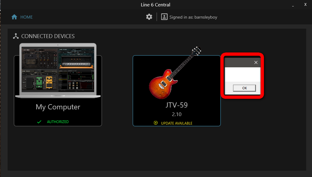

barnsleyboy Posted June 18 Author Share Posted June 18 Now then..... Finally got my JTV59. If anyone has the urge to send anything using Evri - don't they are the worst courier in the world. They've had the guitar for over a month. So I connected to Helix with the VDI cable. Launched Workbench then it started transfering data. All good I thought, then looking at the result on the Workbench screen There are a lot of questions. In fact, a lot of question marks! Any idea what this is telling me? I was hoping to be able to download the factory presets but according to Google they are bound into the firmware update. I have downloaded LIne 6 central, authorised my computer and it's showing that the JTV59 is due an update. When I click on the icon I get a small ok window which closes when I click ok. Is this because I don't have the interface? If that is the case I'm a bit stuffed - firstly no interface, secondly a flat battery that i can't charge as i don't have a battery charger!!! Any assistance greatly appreciated! Quote Link to comment Share on other sites More sharing options...
silverhead Posted June 18 Share Posted June 18 Your Helix device should act as an interface for update purposes. Sounds like your equipment is OK. I would open a support ticket. Quote Link to comment Share on other sites More sharing options...
barnsleyboy Posted June 19 Author Share Posted June 19 On 6/18/2026 at 7:11 PM, silverhead said: Your Helix device should act as an interface for update purposes. Sounds like your equipment is OK. I would open a support ticket. Message back from support: Hi, -you cannot update the firmware via a Helix ! Even if Line6 Central shows the version (it will end with an error message) -Helix can only connect to Workbench HD but this app cannot install/update the firmware -you'd need the Variax USB interface (unless you have a PODH500X which can also work, but using old PODs is not recommended,hardware support can change over the years with Windows updates, new hardware etc) -so we recommend using the Workbench USB interface -you can order it as spare part via a Yamaha reseller or service-center : QN174886 GVRXVDIUSBIF *ASSY UNIT COMPLETE VARIAX https://line6.com/find/service_center/ https://uk.yamaha.com/en/dealers/ there are still some in stock Best regards Line 6 /Ampeg Support Europe I think it is unlikely that the interfaces are still available given the length of time Variax has been discontinued. It also presents me with a problem as I don't have a battery charger so even if I connect it up via interface I can't power the guitar up independently. Grrrrr! UPDATE: I have managed to get rid of the question marks and have found the v2.2 presets here: https://www.vguitarforums.com/smf/index.php?topic=21427.0 If there is minimal difference between my current firmware 2.1 and the latest 2.23, I might just forget about the interface. After all, I can access Workbench through Helix which is the most important bit. Probably more important to get hold of a charger though. Quote Link to comment Share on other sites More sharing options...
silverhead Posted June 19 Share Posted June 19 JTV Firmware versions beyond v2.1 apply to the Standard and Shuriken models and will have no impact on the 59. Quote Link to comment Share on other sites More sharing options...
barnsleyboy Posted June 19 Author Share Posted June 19 Ah, that puts a different slant on things! So basically as long as the 59 is functioning correctly, no real need to update. I'm assuming the actual Firmware jump from 2.1 to 2.2 to 2.23 doesn't affect the quality of the modelling? I don't really want to fork out for the interface when I've got a perfectly good Helix to access Workbench with. Quote Link to comment Share on other sites More sharing options...
silverhead Posted June 19 Share Posted June 19 Correct. No modeling changes. And there won’t likely be any further updates so you should be fine without the interface. 1 Quote Link to comment Share on other sites More sharing options...
