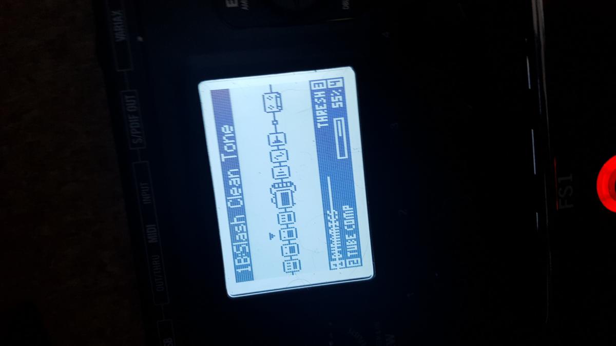

Shurdus Posted June 26, 2016 Share Posted June 26, 2016 Hi all, new user here, sorry if this has been posted before or is a stupid question. On any patch I select, the display shows the seqeunce of effects used and shows the 1 through 4 in the bottom of the diplay right? Well my number 1 is shown in strikethrough text and I have no idea why. This is the case with the factory presets and every patch I make myself. Can some one help me get rid of this so the display is normal anain? Thanks! Quote Link to comment Share on other sites More sharing options...

Shurdus Posted June 26, 2016 Author Share Posted June 26, 2016 Pics?Here you go. It is like this everywhere. I just power up and it is like this for each and every patch. Quote Link to comment Share on other sites More sharing options...
silverhead Posted June 26, 2016 Share Posted June 26, 2016 I expect this is a hardware malfunction in the LCD piece. If a firmware reinstallation does not fix it it sill probably need servicing. Open a support ticket to be sure. However, unless the device is still under warranty, or it is causing a problem with the sound I would try to ignore it. It could be an expensive fix for a purely cosmetic issue. Quote Link to comment Share on other sites More sharing options...

AlexKenivel Posted June 26, 2016 Share Posted June 26, 2016 Yep. Those pixels in the LCD screen are out, on a three month old unit no less. I'm not surprised. I went through three units in under 6 months. Chinese parts... Quote Link to comment Share on other sites More sharing options...
cruisinon2 Posted June 27, 2016 Share Posted June 27, 2016 Here you go. It is like this everywhere. I just power up and it is like this for each and every patch. Looks like a bunch of dead pixels to me. It's up to you of course, but if there are no functional issues, I'd leave it be...these screens ain't exactly hi-def, so it's not like your missing much. Anyplace you take it for service, you're looking at couple of weeks minimum turnaround, and it could easily be longer. The odds of the shop having a replacement screen laying about is basically zero. You'll end up waiting for L6 to send them one, unless you send it back to the mother ship, then you're paying the freight, extra wait time for transit, etc etc. Quote Link to comment Share on other sites More sharing options...
