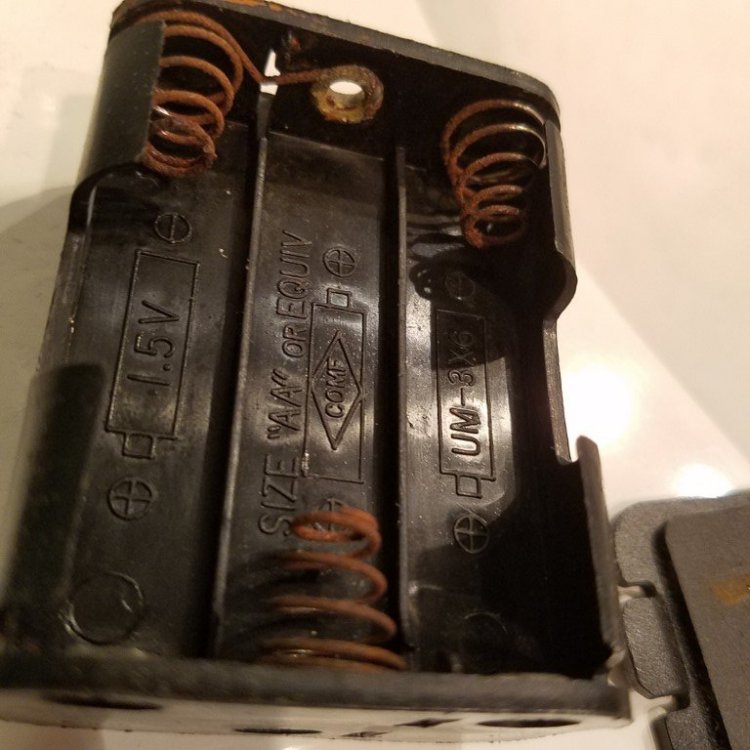

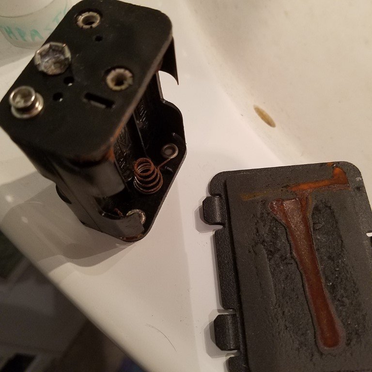

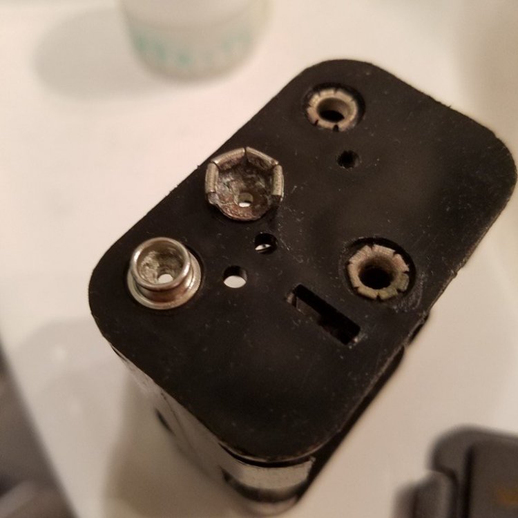

I opened up to check the batteries... NO BATTERIES. Just a battery box completely corroded with BATTERY ACID.
Cleaned it up for HALF AN HOUR with various solvents and scrubbers, but its a goner, I think.
I notice the electronics havent "faded" since I removed it, maybe there was a partial short?

Yeah... that battery compartment looks beyond hope.
If that is in this bad of shape, it makes me wonder about the rest of the guitar... such as jacks, switches, etc....

As for the battery box... I'm sure you can find a used one. Don't worry about capping the 9 volt end in the meantime.... I just stuff a small piece of foam in the battery compartment to keep it from moving around... the plastic battery cover can't conduct so it's all safe. If you are really worried, just put a piece of electrical tape over it.
