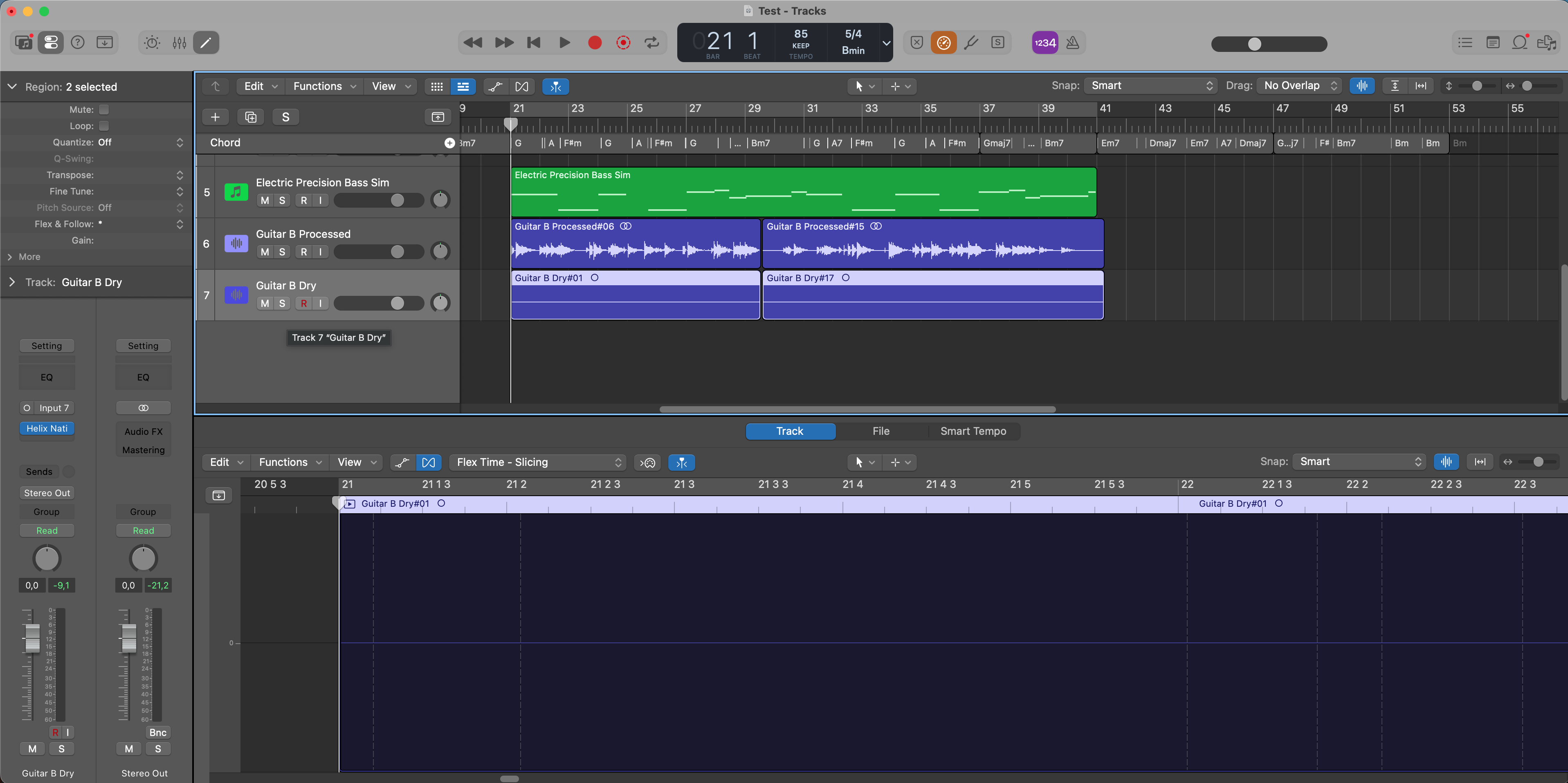

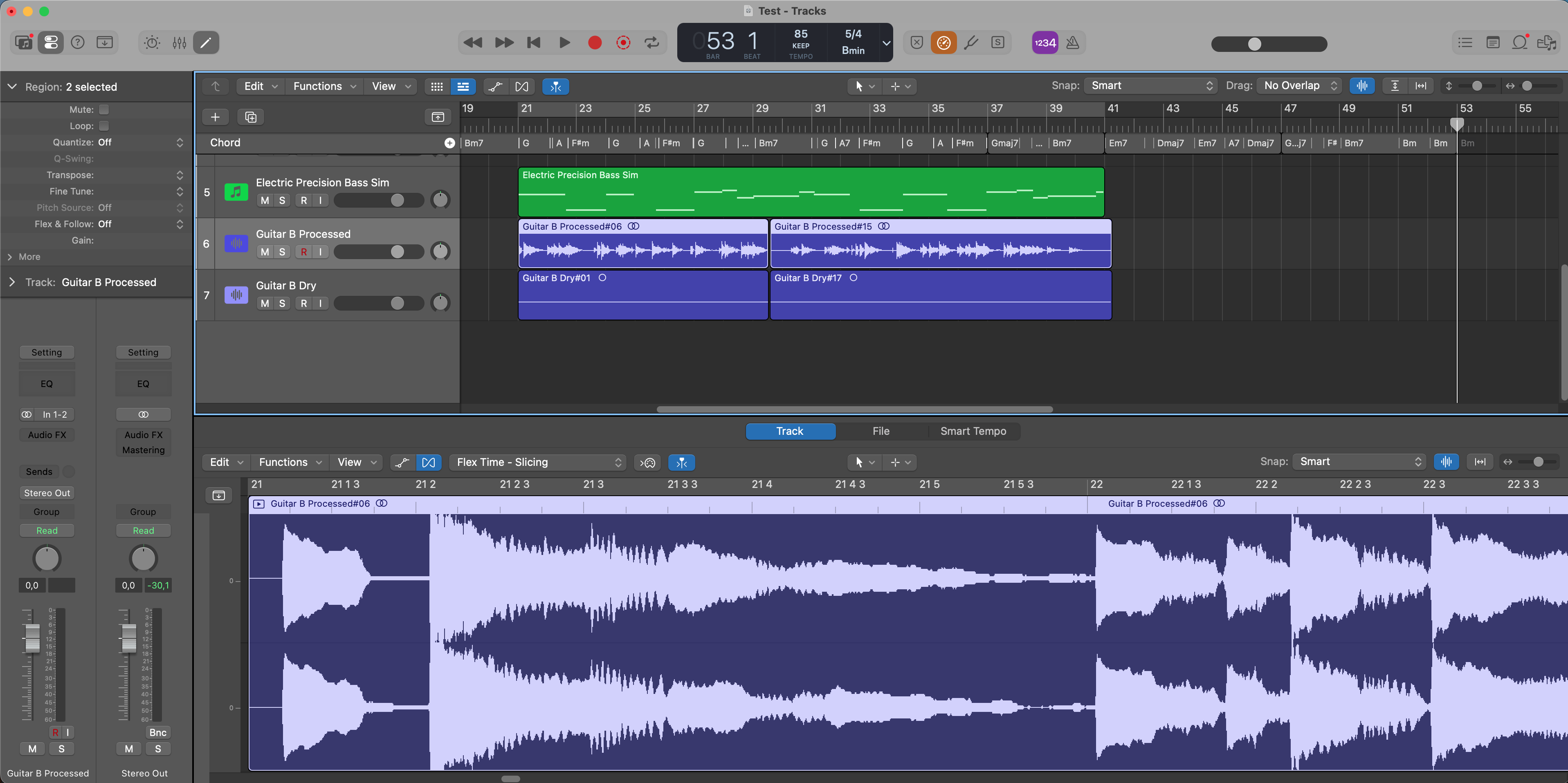

silverhead Posted December 19, 2021 Share Posted December 19, 2021 9 minutes ago, cfitch13 said: ….. So if I'm only gonna use helix native to record in daw and use helix as an audio interface I will have to set the helix on a blank preset so that I don't overlap presets. … I think you misunderstand. Helix Native is not used TO record. It’s used AFTER recording. 4 hours ago, rd2rk said: …. Better Solution: Create your presets on your Helix so that you can monitor your playing DIRECT (no latency). Record two tracks - one processed (from USB 1/2) and one UNprocessed (USB 7). You can then use the UNprocessed track to REAMP the take through whatever Native preset you want? …. Try the suggestion from rd2rk above. Continue to use Helix as your audio interface. In Logic Pro arm two tracks for recording with different Record Inputs as above. Record both track simultaneously. After recording, apply Helix Native to the dry (unprocessed) track. Put your guitar down and transfer the Helix preset you used for the recording into Helix Native. Use this as the starting point and then tweak the Helix Native preset as the recorded track plays back. 2 Quote Link to comment Share on other sites More sharing options...

datacommando Posted December 19, 2021 Share Posted December 19, 2021 1 hour ago, cfitch13 said: So if I'm only gonna use helix native to record in daw and use helix as an audio interface I will have to set the helix on a blank preset so that I don't overlap presets No, no, no! I just spotted your response as I posted my reply, but here we go - let’s get this sorted out. O.K. Using your Helix as an audio interface is fine - I use my Helix floor with Logic Pro X on an almost daily basis - I also have Helix Native as a plug-in. Anything you wish to record complete with the full stereo Helix processing of the chosen preset will arrive in Logic via USB channels 1&2. If you wish to record the unprocessed mono signal simultaneously, that will arrive in Logic on USB channel 7. After recording the dry signal on channel 7, it can be sent back out to your hardware Helix to be re-recorded using any other preset or combination of amp and effects you choose by setting the Helix to listen to the audio in on whatever USB you are sending out from Logic other than USB 1&2. Like wise that dry channel 7 audio can be sent through the HX Native plug-in and any preset or combination of effects you choose. Any audio sent out to the hardware Helix on USB 1&2 will pass through to the audio out bypassing any Helix processing and effects. That way you can play along with backing tracks from Logic, YouTube, iTunes etc. while jamming along using favourite Helix tones. Hope this helps/makes sense. See the Manual re: Audio/USB Here’s a video on re-amping using a LT exactly the same for the floor. And here is using Native: 3 Quote Link to comment Share on other sites More sharing options...
