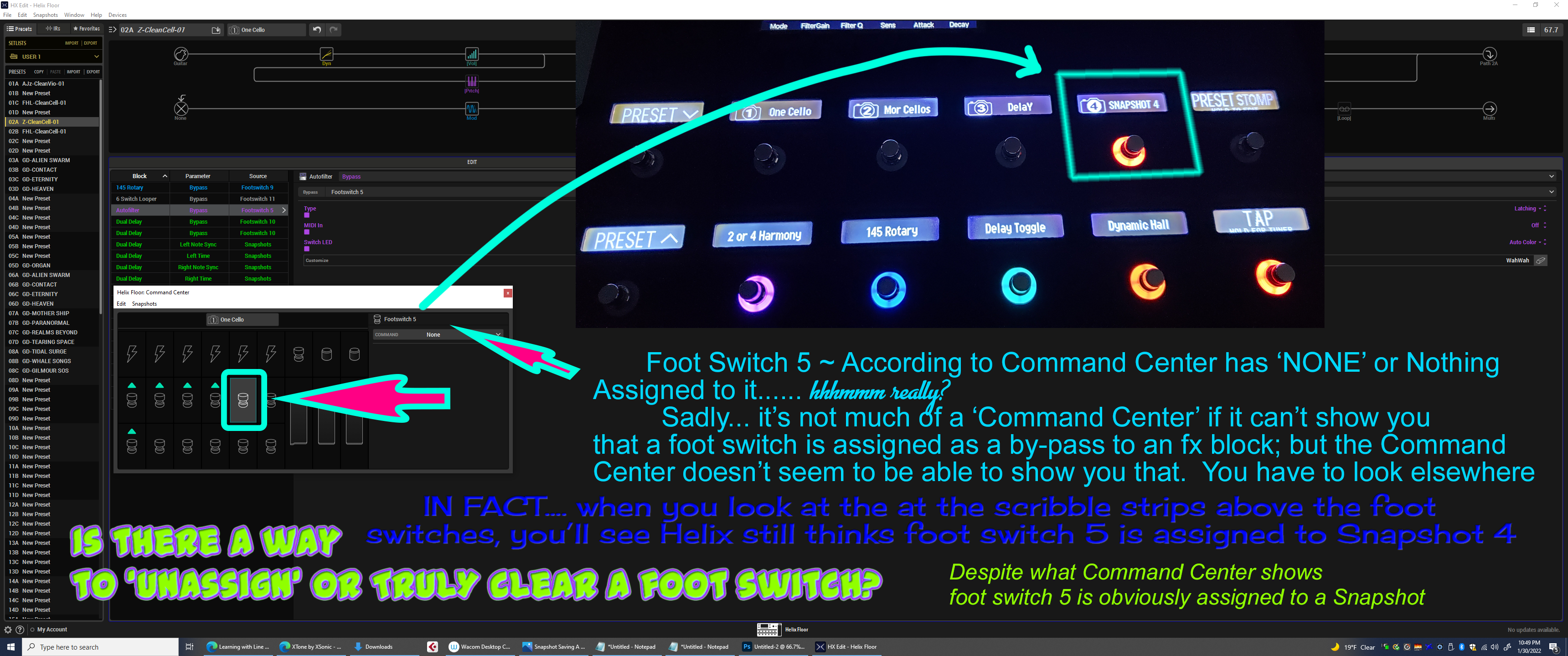

              It's rather frustrating - the command center doesn't seem to show if a foot switch is assigned to bypass/enable an fx block, correct?   This is true, right?  Inside the command center you don't know or can't see that a specific foot switch is already assigned to bypass/enable an fx block?         Forgive me for thinking something like "Command Center" of foot switches would show me exactly what each foot switch is assigned to do?  It does not seem to honestly do that.   If a particular foot switch TRULY does absolutely NOTHING, and is assigned to absolutely NOTHING.... then, and ONLY THEN would I expect the Command Center to show the foot switch COMMAND = NONE.    Maybe that's just too much common sense, or maybe it was too difficult to program in HX Edit.
   You can see the screen capture below.....  PLEASE, PLEASE, PLEASE..... click on the screen capture image to enlarge it.   initially I had the Helix set up in Snapshot /Stomp mode, but I want to change that to set up EACH foot switch as I want in the command center.
QUESTION:  Before you go about using Command Center to customize your foot switches, setting each individual switch however you want...... are you supposed to "clear" or "reset" the preset back to zero or nothing or back to a state where foot switches were not assigned to anything?
   In Command Center it shows one of my foot switches (foot switch 5) is assigned to 'NONE'; but in fact the switch is still assigned to a Snapshot 4. Apparently the Command Center has some issues.... or you're supposed to somehow "clear" any/all previous foot switch settings.
Anybody Use the Command Center - have any advice on clearing or resetting it?
Is there somewhere else in HX Edit you have to go to 'unassign' a foot switch from being a preset?
Frustrated in Philly

In preset mode the footswitches select presets, and the scribble strips reflect that.
In snapshot mode the footswitches select snapshots, and the scribble strips reflect that.
In stomp mode the footswitches select functions, and the scribble strips reflect those functions.
If a FS is assigned to bypass a block, the scribble strip shows the effect that's in that block.
That's one of two ways you know that a FS is assigned to bypass a block.
The second way is by looking in HX Edit at the "Bypass/Controller Assign" pane, which lists all of the FS assignments EXCEPT those made in CommandCenter.
When a FS is assigned a function in CommandCenter the scribble strips reflect that function.
BYPASS is NOT assigned OR reflected IN CommandCenter, it's assigned in the main UI and shown in the Bypass/Controller Assign pane.
If a FS has multiple assignments the scribble strip says "Multiple (X)" where X=the number of assignments.
If you want the scribble strip to say something specific you can enter the description either in CommandCenter (if it's a CommandCenter function) OR in Bypass/Controller Assign if it's a bypass or block parameter function. If all three are assigned to one FS, you can change the scribble strip text in either CommandCenter OR any of the Bypass/Controller Assign listings for that FS.
There is no way to clear ALL assignments from a FS or to clear ALL assignments from ALL switches.

In Bypass/Controller Assign if you right-click a FS assignment and select CLEAR ALL ASSIGNMENTS it will clear all functions assigned to that FS EXCEPT those assigned in CommandCenter. Those need to be cleared IN CommandCenter.

There are two places to assign footswitches...
  • Controllers view.... this is where you assign stomps, controller values, etc... etc...
  • Command Center... this is where you assign specialty functions such as midi control and more...
Something assigned in one does not show in the other because they are very different functions that happen to overlap. What you can do in one area, you cannot do in the other - but it can use the same footswitch.
I can see where this might be handy. You should suggest it on Ideascale:
https://line6.ideascale.com/a/login
Your question implies that you think you can program the footswitches in CommandCenter to do whatever you want. This is not the case.
CommandCenter can be used to assign switches in stomp mode to do more than bypass and parameter control, but NOT bypass and parameter control. Those functions are assigned in the main UI and Bypass/Controller Assign.
In CommandCenter you can additionally assign stomp mode footswitches to call presets, call or toggle snapshots and send MIDI and computer keyboard commands to external devices.
IOW - footswitches are assigned different functions in different parts of the UI - Bypass/Controller Assign and CommandCenter.

6 hours ago, VmusicV said:
This forum is basically worthless.
Yeah, well I guess everyone is entitled to an opinion, but not their own facts!
You initially asked -
“Anybody Use the Command Center - have any advice on clearing or resetting it?
Is there somewhere else in HX Edit you have to go to 'unassign' a foot switch from being a preset?”
The short answer to both of those questions are - yes, and yes.
Do yourself a favour and read the HX Edit Pilot’s Guide Rev S (v3.11). This so simple that you don’t even have to go looking for it, because it is built in to the GUI. Simply click on the “Help” icon (question mark in a circle) in the lower left hand corner of the HX Edit window.
Now once you have accessed the relevant document, scroll through to page 39. Here you will find instructions on how to
”Clear All Assignments - Deletes all Bypass, Controller, Snapshot, and MIDI assignments that exist within the current preset.”
Next, continue through to page 46, and you will discover
“Cut, Copy, Paste, and Clear Commands
Just as on your Helix or HX Effects device, there are options available to easily Cut, Copy, Paste, and Clear Command Center assignments. Using these commands from the application’s Edit menu*, from the individual controls’ right-click context menu, or using “Keyboard Shortcuts”, you can copy and paste an assignment from one controller to another, copy & paste all command assignments within the current preset to another preset, clear the current command assignment, or clear all of the preset’s current command assignments.”
