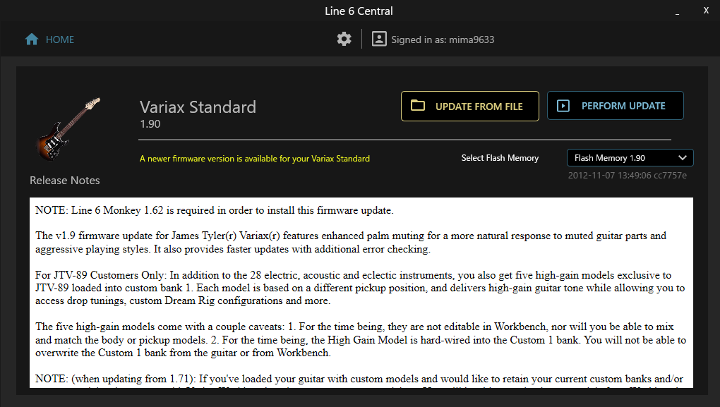

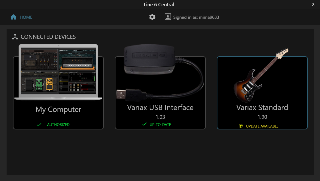

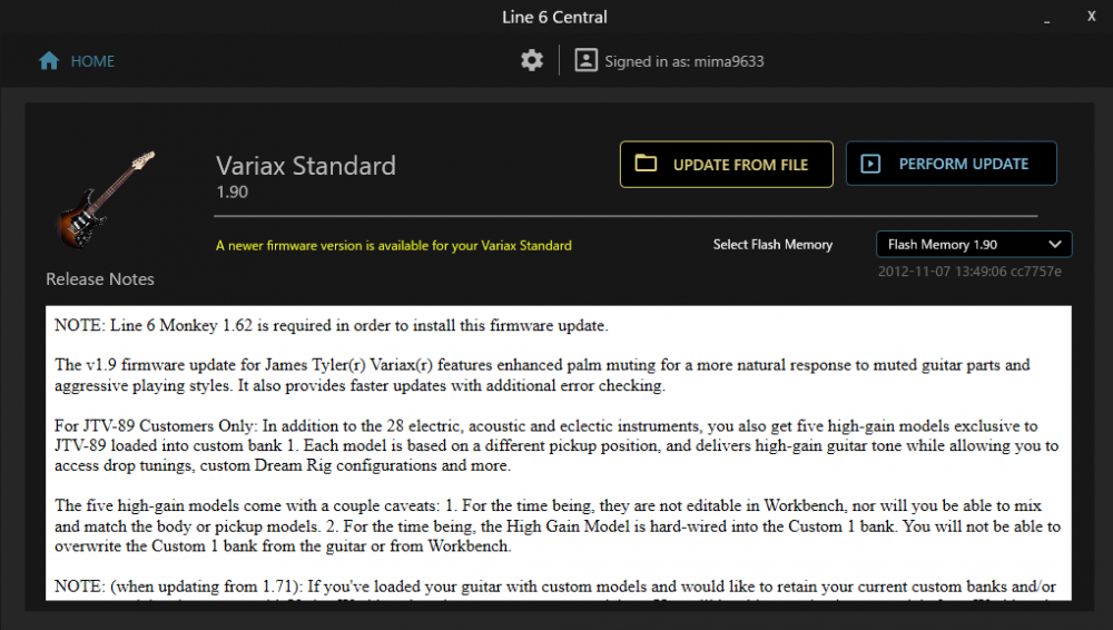

hurghanico Posted yesterday at 06:36 PM Share Posted yesterday at 06:36 PM Based on what was officially said it is not possible to downgrade a Variax Standard to firmware 1.9. read here: Variax Standard with 1.9 ? But wait!!! According to the description on YouTube of the following video, it is possible to downgrade the Standard using the Line6 Central app. Is this true? _______________________________________________________________________________________________________________________________________________________________________ All about POD HD500/X help and useful tips Quote Link to comment Share on other sites More sharing options...
psarkissian Posted yesterday at 09:05 PM Share Posted yesterday at 09:05 PM What silverhead said. hurghanico,... as for rolling back to v1.90,... no can't be done, I've tried it. Standards are post JTV types that have differences in the program, so Monkey won't roll back before v2.00 firmware. Make certain that it comes up as a Standard icon in Monkey,... then re-Flash the firmware. If it still doesn't sound right after, then have the set-up checked by an authorized Line 6 service center in your area. If the JTV icon comes up, then it was programmed incorrectly. If you are in the US, sending it to Line 6 for reprogramming or board replacement at a Line 6 service center in your area would be two options. If outside the US, then the Line 6 service center in your area should be able to get a replacement board. Y22xx,... Indonesia 2022. Not the last, some in 2023,... haven't seen many of those across my bench,... maybe when they are couple years old and need servicing. https://line6.com/find/service_center/ Quote Link to comment Share on other sites More sharing options...
TheBeatnics Posted yesterday at 09:40 PM Author Share Posted yesterday at 09:40 PM Your answers are all helpful and really appreciated! I'll check everything out in Monkey/Workbench to see if it's all copacetic. I've barely used this Standard, still have plastic on the pick guard, Lol. Yamaha could've used a better quality guitar for this, 3 single coils. Even the lowest budget priced Pacifica would be an improvement for heaven sakes. Want to make sure it's going to be a real upgrade for my needs before I start altering anything for my stage work. The Standard's pick guard for instance physically prevents adding a common divided MIDI pickup without making alterations, unlike the 600. On gig's have reverted back to my 600. Quote Link to comment Share on other sites More sharing options...
hurghanico Posted yesterday at 09:50 PM Share Posted yesterday at 09:50 PM On 1/28/2025 at 10:05 PM, psarkissian said: so Monkey won't roll back before v2.00 firmware Yes, but have you tried rolling back to 1.9 using Line6 Central (instead of Monkey)? The guy in the video posted above wrote that it is possible that way. I'm just curious if it's true. As for me, the Variax I'm still using is a 700 that I'm happy with as is, no need for different firmware. _______________________________________________________________________________________________________________________________________________________________________ All about POD HD500/X help and useful tips Quote Link to comment Share on other sites More sharing options...
