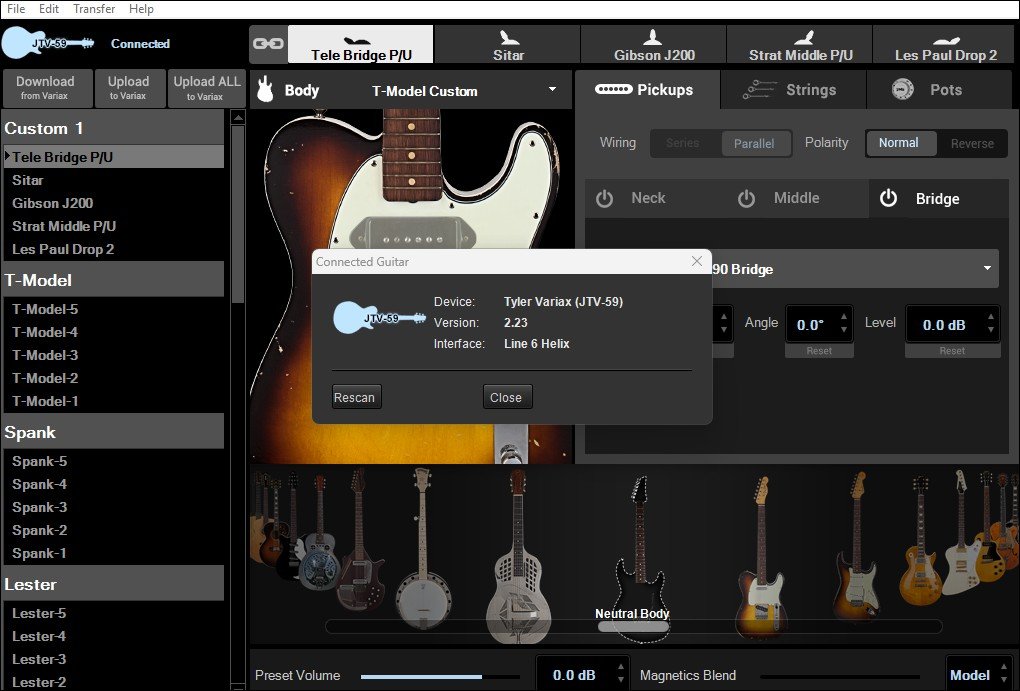

You're quite right - running the Variax with just a VDI cable into the Helix Floor does work without the need for either the battery or a TSR cable. Workbench HD loads and recognises the Variax allowing me to fine tune and export settings (see picture) - BUT - the only way to get Workbench HD to function is via this Helix Floor process (workaround) and not direct from the Variax to the desktop (the preferred route).
