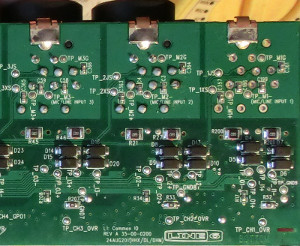

Hi there,
The most of your problems will be the fixed by grounding the in an outputs propertly.
But first   If there is warranty   Use it ! Line6 will help You!
This Happend because  the Switch signal which detects an insertet XLR OR 1/4" is based on Ground Potential.
The Pluged in detection swiches are ativated by losing Ground.
The Ground Potential for each channel is connected via seperate spring elemet's to the casing. (Picture)
The casing GROUND is only connected by screws.
The most m20D's where this happend are an few years old where the surface begin to oxidate and the Ground Potential gone away.
The Harware had Ground Point's for Cable connection's but they are not used.
For the Signal in the Ground is not nesseary, but for the input and output detection of XLR OR 1/4". If it lost Ground it will detect 1/4" Jack first.
For me I solved the Problem by Grounding all canal 's and the top back and bottom case  by wire and brought  them to one Ground Point .
Nice Mixing everyone.

I did this to bouth PC boards . They are similar. On these boards are the mic in, line in monitor out and main out jacks. Yes one for  each row of Jacks.
jack_pcbs.jpg The Phone ,Aux in , SD Card , USB Port , Foot Switch are on seperate board's.

I applied the above fix and can confirm my headphone jack is operational again. I was loosing signal on one of the 1/4 jacks half way through a show on stereo linked 1/4 channel  (per viewing the wav files I was able to discover this) I am going to perform some more tests on the inputs tonight.

Hello thank you! I did the same thing and it worked! Both channels and headphones!
