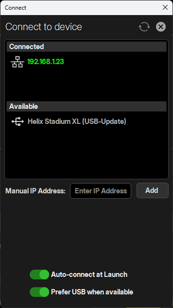

PiFromBRC Posted October 15 Share Posted October 15 I updated to 1.4 yesterday, thrilled that when I went to connect it said "USB-Update". Update went well, but the app is only recognizing USB-Update and not the actual USB connection. I'm right back to having to put in the IP. W11 user. 1 Quote Link to comment Share on other sites More sharing options...

theancientone Posted October 16 Share Posted October 16 (edited) I'm having the same issue. I've updated the firmware and the application but I get an error saying USB is for updates only. I've tried uninstalling the app and the drivers and blowing away all folders but after reinstall the same issue pops up. I have no idea what to try next. Edited October 16 by theancientone Added screenshot of app version Quote Link to comment Share on other sites More sharing options...

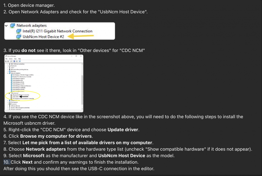

Wah-bisca Posted October 16 Share Posted October 16 @PiFromBRC, can you try the following: 2 Quote Link to comment Share on other sites More sharing options...

PiFromBRC Posted October 17 Author Share Posted October 17 On 10/16/2026 at 3:48 PM, Wah-bisca said: @PiFromBRC, can you try the following: UsbNcm Host Device 2 showed up. No tree called 'Other devices'. Went through the process on the UsbNcm as you described for the CDC NCM. That didn't work. Quote Link to comment Share on other sites More sharing options...

elkabong Posted October 17 Share Posted October 17 Having exactly the same kind of problem. Unit constantly disconnects because it stays on Wi-Fi even though the USBC is plugged in. Try to select it and it just shows the SBC for update and when selected it still goes back to the Wi-Fi for editing. Tried on two different computers. Same result all firmware and edit apps updated to 1.4 Quote Link to comment Share on other sites More sharing options...

elkabong Posted October 18 Share Posted October 18 On 10/16/2026 at 8:47 PM, PiFromBRC said: UsbNcm Host Device 2 showed up. No tree called 'Other devices'. Went through the process on the UsbNcm as you described for the CDC NCM. That didn't work. I don't see either one of those kind of host devices in my control panel at all. I downloaded and installed 1.4 as well as the driver download from line 6 Quote Link to comment Share on other sites More sharing options...

MojoAxe Posted October 20 Share Posted October 20 I have the exact same issue. I’ve tried connecting my Stadium to the app via USB on two different Windows PCs and neither work. I’ve tried rebooting, reinstalling the app, turning WiFi and USB settings off and back on again, granting the Stadium app permission to go through the firewall, and a number of other things but nothing seems to work. I was going to try editing the UsbNcm settings per the suggestion above, but I don’t have any idea what that parameter is, and I received a warning from my computer that changing the setting was not recommended. The last thing I want to do is crash my computer. I’ll just have to put up with regular app dropouts until somebody discovers a solution. Quote Link to comment Share on other sites More sharing options...
