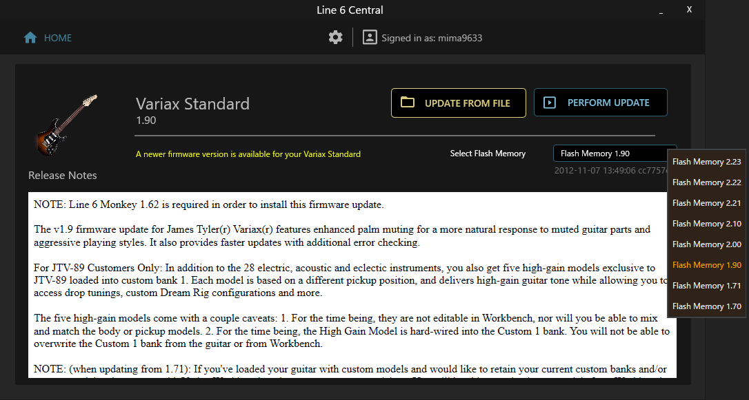

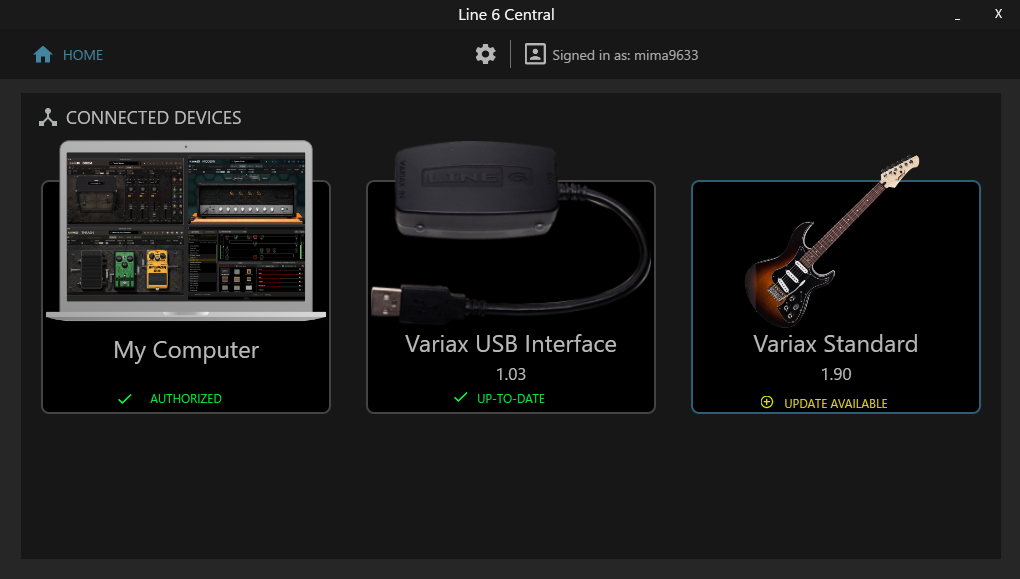

mima9633 Posted June 4 Share Posted June 4 With Line 6 Central, you can downgrade the firmware to version 1.9 even on the Variax Standard. Quote Link to comment Share on other sites More sharing options...
